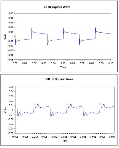

As shown in the little movie, it's become apparent that simply feeling for the right position is pretty much the only way to do it. At first blush I thought the laser idea might work, but what are you really targeting. It's the same with the square wave thing, I can tell if the seal is changing 'cuz I'll loos bass, and I can tell that things are changing in the highs, but as has been pointed out to me, who the heck know what's right.
