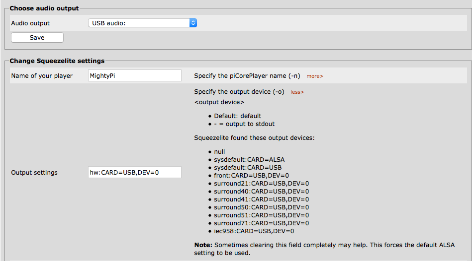

Mar 6, 2016 at 4:55 AM Post #29 of 47
Hi B0bb,
I installed LMS and Picoreplayer.
I can get sound from HDMI and analog, but there's no setting to use I2S output from RPI itself, only Hifiberry, IQaudio, raspidac, rpi dac
How did you manage to use rpi's own i2s output?
Also tried to connect XMOS usb dac, not working either.
Can you shine your light on this please?
Regards,
Alex
Mar 6, 2016 at 4:06 PM Post #30 of 47
  Hi B0bb,
Regards,
Alex
The RPi has a built in webserver. Point your web browser to its IP address to get to its config webpages.
Click on the Squeezelite settings tab and select the I2S option.
The I2S device type has to be manually specified as it is not auto detected
This screencap is from my Soekris R2R DAC via I2S
USB is auto detected but you have to check the software is selecting it correctly
USB to my LKS MH-DA003
If you change the DAC the descriptions will change, this is the one from my Schiit Yggdrasil
The RPi will do 384KHz out of the USB port, for I2S the linux kernel ALSA modules need to be patched and the RPI linux kernel rebuilt.
Here is the link with the instructions and patch: http://tinyurl.com/jtokvhy
NOTE: This is experimental and not officially supported and is specific to the kernel version the patch was created on.
