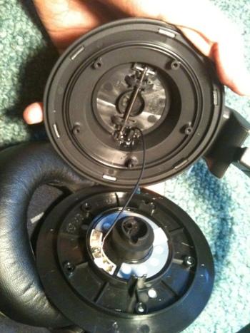

I think I understand your question. It can be difficult to determine whether the ringing (in this case, the sharp ridges on the waterfall plots) are the result of the driver, enclosure, or both. One way to figure this out is to use a variety of different couplers with the headphone and see what persists. The best way is to remove the driver and measure it directly. I usually take several types of measurements. In this case, I'm positive the 7kHz ringing is a result of the driver.

In the left channel, the 6kHz ringing is a result of the driver that could possibly be slightly exacerbated by the enclosure. The 12kHz ringing I'm not too sure. That could be an enclosure effect as I don't see it on the right driver. The pads are slightly different. But there could be variances in the drivers themselves.
I would need to disassemble the headphone and measure the isolated driver to be sure. But quite frankly, it's not worth my time. If the K550 had some truly outstanding qualities to make up for its deficiencies, or was dirt cheap, than maybe.
