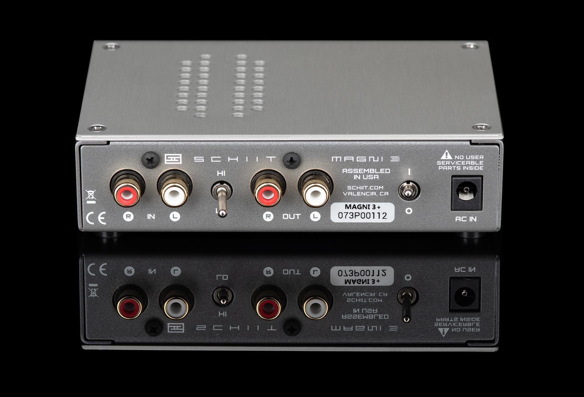

The Heresy is a sub-ohm amp, so it should have low enough impedance to deliver decent sound quality to the 80-ohm DT-770.
I'd try it with the low gain setting though first, because you shouldn't need much power to drive the 80-ohm DT-770. And it might give you a lower noise floor. There should be a switch on the back for this. You can see it below, between the two sets of RCA jacks...
If you can't get enough volume with the lower gain setting, then switch back to the higher gain setting.
The Heresy probably needs a standard -10 dBV consumer line level input btw. If you're using it directly with a TT, then you may need a separate phono preamp to get that, if your TT doesn't have one built in.
