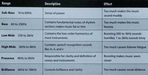

So instead of simply saying bass, mids, or treble, or the somewhat more detailed sub-bass, lower/upper-mids, and so on, we can talk about sonic signature in proper detail by describing the exact frequency range we're referring to. This will alleviate the problem of one person saying "the mids are too forward" and we have no idea what frequency range the person's talking about. "mids" can range anywhere from 250Hz to 4KHz, and without saying exactly where in the frequency range one is talking about, it's practically useless. Same with treble and bass--too many people have no idea what they're talking about when they use those terms.

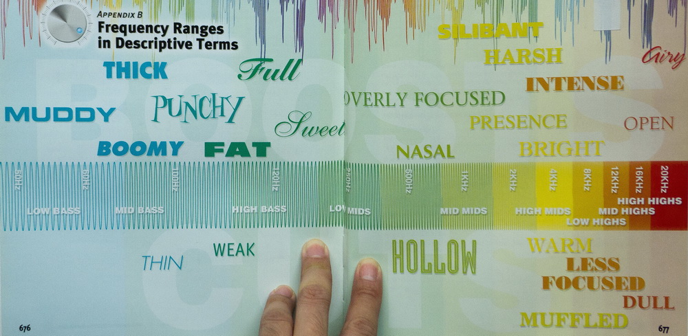

For those of you who are more visual, here's a very helpful chart that makes it extremely easy to describe sound in detail (taken from a couple of the books I own):

Anyway, I agree with the general idea and I like the visual chart.

Btw, where'd you get the cool chart lol
Mar 30, 2011 at 6:22 AM Post #5 of 15
The color chart is from The Guide to MIDI Orchestration, by Paul Gilreath. Not useful to anyone here unless they want to become serious composers using today's cutting edge orchestral sample libraries and DAW's. The section on mixing/effects is somewhat universal (though still written in the context of orchestral compositions only), as shown by the color chart, but 90% of the book is useless to the members here, save maybe a few who are serious composers.
