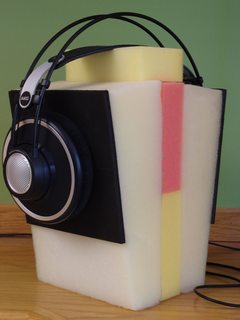

Here is the measurement system we used for the measurement above:

Great job!
This gives us good insight on what yo expect when it comes to the response frequency of ie800s!
