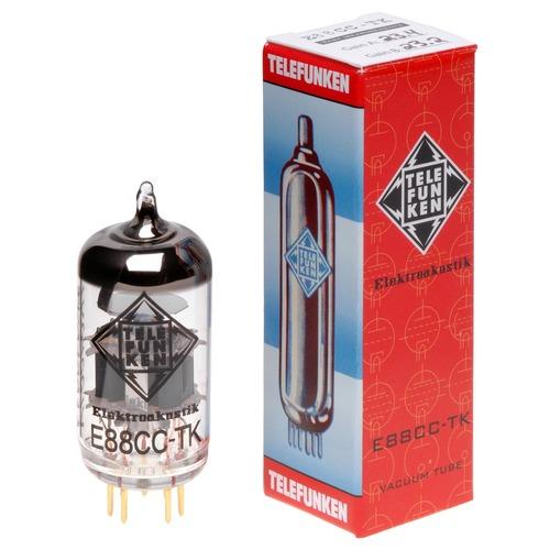

#3 Telefunken E188CC 60's Ulm, Germany – 117.3 Ave Points
Man these are some sweet tubes – finishing just a hair below the CCa's with 117.3 (really a three way tie for #2). A bit sweeter then the CCa's, with a Musicality and Euphonics actually greater then the HG's. Sort of between the best Holland tubes and the HG's in the Euphonics department, finishing at #3 in that category. Excellent Clarity, Detail and transparency – just less then the HG's and CCa's – finishing #4 and #5 respectively. They just seem to get it right in a very nice way – I could listen to them for hours. Bass was deep with excellent definition – ranked at a tie there for #2 with Amperex PW and Philips Miniwatts.

#10 Tie Siemens '65 E88CC Gray Shields (Stamped Plate Date Codes) – 107.6 Ave Points
Telefunken 60's E88CC Ulm, Germany – 107.5 Ave Points
Well two well know and great examples of the German vintage house sound. In a 'normal' tube shootout, I'm sure these would have scored much higher. But up against a couple of pairs of CCa's, a pair PW's and the Tele 188's – Ugg! But don't let the ranking dissuade you from these awesome tubes. Nice Detail, and Clarity, good Sound Stage and Bass. Not the last word in Euphonics, but Musical enough. I feel the Tele's should have ranked a bit higher – one of the tubes started to develop a slight low level buzz near the end of the review and may be going bad. They still had really nice warmth for their level of Detail. Of the two - the Tele is the warmer, the Siemens is the more detailed. Comparing the Siemens E88CC to the Siemens CCa of the same year – well the CCa's were clearly superior in nearly every respect, and not just subtly better either. I would say both of these tubes are 'Best Buys' under $175/pr.
