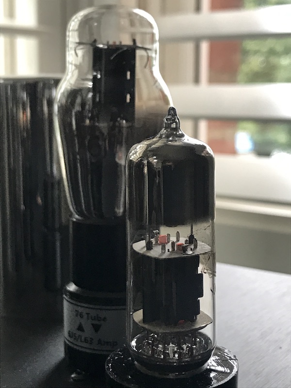

I decided to try 6080 tubes and I bought this:
This tube makes the Blue Halo amp super quiet. There is no tube noise whatsoever (like hybrid ECP T4 amp) !
It sounds great with Raytheon 6J5G tubes. Definitely better than all 6SN7 tubes I have tried.
You can likely run the 6080 alone without the 6J5 tubes as the 6J5s would be pretty much idle when the 6080 is running (6080 tubes are so powerful that they do all the work when run as a combo with other tubes). Generally the most powerful tube (lowest anode/cathode resistance) will do most of the amplification/work when running the amp in combo with the 6SN7 and 6J5 sockets filled.
For a super quiet amp, also try running a pair of 6N6P in the 6J5 sockets via adapters. Try the pair in 6J5 sockets alone (nothing in the 6SN7 socket) or in combo with other tubes in the 6SN7 socket to see what gives good tone/super low noise. You could also use a 6N6P to 6SN7 at the same time (so three 6N6P running at the same time ) . When dual section (dual triode) tubes such as the 6N6P are run the in the 6J5 sockets, the adapters parallel their sections which reduces the anode resistance by half, and cuts down on overall tube noise.
Tubes that have lower amplification factor, or tubes with low anode/cathode resistance, will generally have lower tube noise. Big tubes such as the 6080/6AS7/6BX7/6BL7 have very low anode resistance and most should be very low noise. Tubes such as EL34 also have low anode/cathode resistance and would be very low noise in the Blue Halo. Some other small tubes such as 6C45P, 12BY7/12HG7/12GN7, and others also have quite low anode/cathode resistance despite being small tubes, and should be low noise as well.

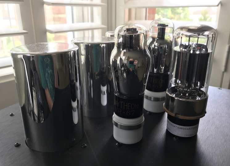

Been a little quiet on here, so thought I'd make a post. Had a friend come over yesterday evening and we were listening on the V6 Thunder. Loaded her up with 6 5998 tubes and 2 6N7G and plugged in the hard to drive LCD4 and Abyss at the same time. The LCD4 and Abyss are quite hard to drive headphones and the Abyss also has low impedance. There's no way an OTL amp should be able to drive these two headphones so well at the same time - but it does. Thanks again Mischa!
