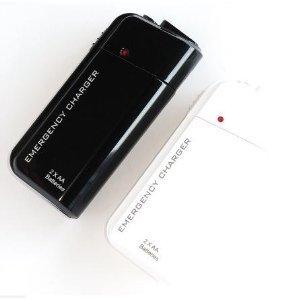

My two and a half year old Clip+ lasts maybe 10 or 11 hours in real use. I can extend that at least twice (or charge the battery twice) by using this extremely cheap and small external battery pack which uses 2 AA batteries and connects via USB:
In practice with the iRivers I preferred to upgrade the internal battery so now I get about 25 hours play back from one charge. The battery pack I use with the Clip+ is small enough that I strap the items together with a rubber band and it has proven useful and convenient. I think that if/when the internal battery fails in the Clip+ I will be able to run it fine with the external pack. With the iRivers end of life isn't a problem because the internal battery is easily replaced.
In effect I have the best of both worlds. I have a couple of devices which have long battery life but also the option to supplement that with widely available AA cells if I can't be near power point for a few days. This is ideal imo. I used to travel a lot in places where mains power was unreliable and occasionally unavailable and at the time I did appreciate the convenience of a MiniDisc Walkman which got a long life from a single AA cell, but when I changed to an iRiver H340 I didn't miss out because that same conveneince was still available as a fallback if required.
My point is that almost any modern device which can charge via USB also allows you to use a small, cheap external battery pack so if you're going to be away for a few weeks without power you can get by with a few packs of AA or AAA cells just as easily today as you could 10 years ago with stuff that could only use AA or AAA cells.
