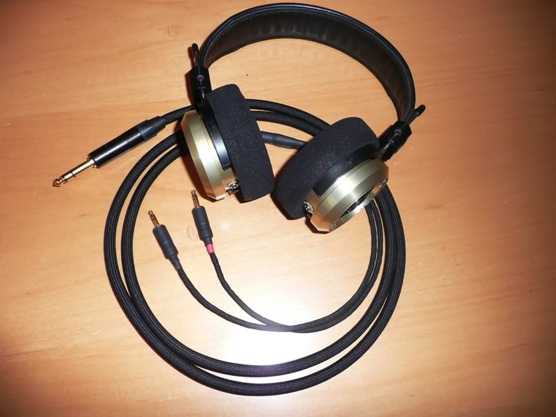

This is Nylon Multifilament which is a lot softer/nicer IMHO.
The pic shows the 'Y' which is the barrel of a Neutrik (a trick I got from Bonthouse).....
I used the same stuff on my 325i's.

^Any safety tips for the solder pads? And how did you fix that?
By the way, for the y-split, did you just feed the wires through the barrel and heat-shrink the whole thing? And the barrel is from a 1/8 connector, right?
