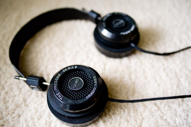

I recabled my SR80i's recently. It was my first DIY electrical/audio work, and I was pleased with how it turned out. Here's what 4.5 feet of Mogami 2893 inside some nylon multifilament with a Neutrik 3.5mm jack on the end looks like on the Grado's:
