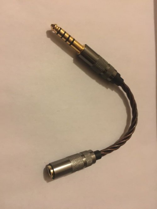

Here's a picture of it. You think it's at fault?

Aug 30, 2021 at 3:54 PM Post #6 of 9
It might as well be, if your amp doesn't use the ground pin of the 4.4 port (which could then be used for the common grounf of the 3.5 port) and if the ground for the 3.5 adapter is made from combining the L and R negatives.
Can't say for sure, of course, but it's something to think about.
Do you have some 4.4 headphones to use directly and to see if your amp behaves the same?
Sep 1, 2021 at 12:24 PM Post #7 of 9
Hey! I think you may be right! I have Phillips Fidelio X3 that are natively balanced. They don't have a 4,4mm jack, but I have a 2,5mm-4,4mm adapter that fits the jack in the amp. They also have a single-ended cable that terminates into a 3,5mm male (which can be used with the 3,5-4,4mm adapter) I tested both cables with both adapters, and I had the same problem on these phones as I did with my single-ended DT1990's. But it worked flawlessly with the 2,5mm-4,4mm adapter even at deafening listening levels.
So, it's probably the adapter then... but I still kind of want an adapter that will convert 3,5mm to 4,4mm without triggering the protection circuit or whatever is happening. Is this impossible or is it just a crappy adapter ?
Sep 1, 2021 at 12:30 PM Post #8 of 9
So the 4.4 balanced output has L+, L-, R+, R-, and also a ground, which sometimes it's not actually connected to the board internally.
If it would be connected, you should be able to use an adaptor which uses the L+, R+, and the ground of the 4.4 output.
These adapters are not so common from what I've seen some time ago. If you can't find one like this, you could try tinkering with the existing adapter or make one yourself or something.
Also, as the amp acts like this when using your existing 4.4 to 3.5 adapter, I think it would be wisest to stop using it, as you may damage something.
Sep 1, 2021 at 12:48 PM Post #9 of 9
Now if the ground pin on the 4.4 port is not connected on the Topping A50S board (like it's not connected on the Sony WM1 players, for example), you could also try something like this - using the ground of your AMP's 3.5 port:
It's basically an Y cable, with one 4.4 male and a 3.5 male that both go into the amp, and a 3.5 female where you can plug your 3.5 headphones.
The thing is that for both the "Proposed adapter" above and this adapter in the image in this post, the volume won't be as high as when just plugging headphones with a balanced cable directly into the balanced port, but it should work safely.
It would be something like this, more precisely:
I used something like this on my Sony WM1A player, and it works fine. Whenever there is something plugged in the 4.4 port, the 3.5 port is not active, so both ports are not outputting sound or something. It's just using the ground pin of the 3.5 port.
