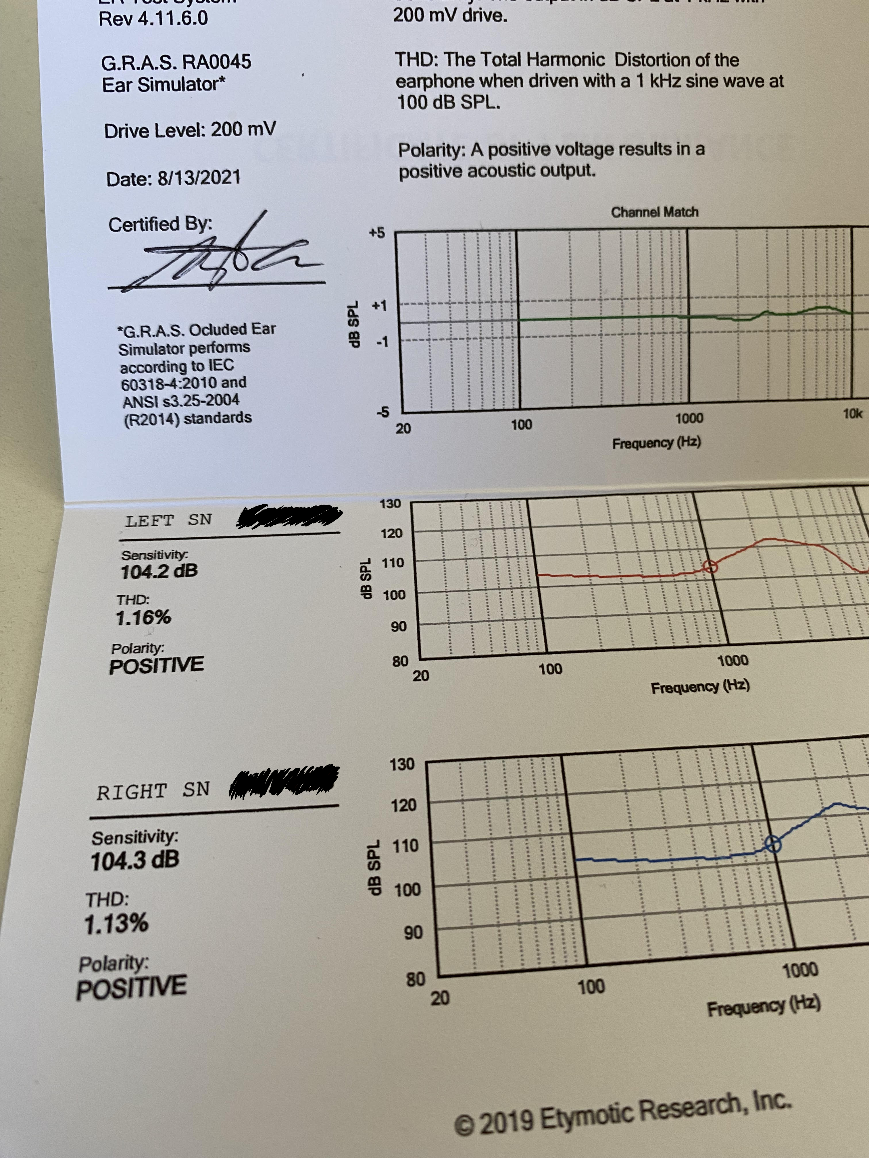

I took out the certificate I got with my ER4XR and saw that distortion for my units was over 1.1%.
Funny, I've never heard any distortion with my ER4s.
Then I saw that the THD was measured at 100dB.
There's no way I'd ever listen to my music that loudly.
My question is, am I right to assume that a 1.1% THD at 100dB means very little when listening to music at normal volumes of about 50-60dB?
1 % of harmonic distortion means nothing at low frequencies. At some higher frequencies it may be audible with some test signals. However, the distortion should be signficantly lower at lower listening levels, so you probably can listen to DANGEROUSLY LOUD (for example at level 90 dB) with no more than 0.1 % THD, which is inaudible. Also, very low level of audible distortion tend to make the sound richer/warmer, so even if you heard the distortion the effect would be positive rather than negative to the enjoyment.
No panic warranted.

THD is famous for one thing, and that's not being relevant to predict listener preferences. As you suspect, the distortions on the er4XR aren't that high with a lower signal. It's not great but also not particularly strange for a single BA driver. I wouldn't recommend this to people who will listen loudly because some of the mess increases near 1kHz and that's not a frequency range where we want any mess to be loud, but beyond that, your pair has better channel matching than most IEMs, one of the best isolation, and it's small. I can think of worse choices in life.
1% means 40dB below signal. From that you can understand that it's probably audible, but it's one of those times when it might be good to invent a distinction between audible and clearly noticeable, where audible would be exactly what it means, and noticeable would be that we notice and identify it while playing music. It's really hard to notice THD at or below 1%. First because -40dB is already very quiet compared to the full scale music playing over it so a lot of the THD will hopefully be masked. And second because instruments and voices contain a lot of harmonics already. Subjectively THD will alter the sound, but it doesn't mean we'll know where and how, usually we can't tell that anything is out of place thanks to not having a direct comparison with the exact same FR and no distortions. You can go listen to a super low THD IEM and pretend to understand what part of the perceived difference is THD, but I'd bet good money that you'd be wrong. The frequency response difference between the IEMs and the impossibility to volume match them will surely throw you completely off subjectively.
The SR is very close in measurements and while it seems to do a little better at higher listening level in term of distortions, it's still pretty bad compared to most random vented dynamic drivers. If THD wakes you up at night, I would suggest to never touch a balanced armature ever again.

Your ER4XR would be lower than 0.5% below 90db It wouldn't mean anything at all. It also sounds like there trolling by riding on the "Ew....Single BA" since the ER4SR they tested was 0.3% at 100db pretty much as good as Planar/DD headphones. It the same people who tried to shut me down when a poster showed a ER2XR at 1.98% at 1KHz(also 100db) as they would scoff at the ER4XR being higher THD.
Both Reddit, ASR & SBAF have became foam in the mouth toxic about using the ER4XR as to why BA headphones need fade away. I still remember having folk getting teary eyed at me showing that the ER4XR & ER4SR can handle 6 ~ 12db bass under-125Hz no problem.
