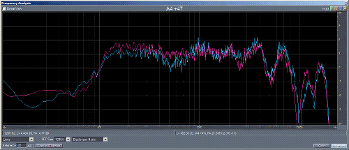

This is an FR chart on ear coupler after some extensive testing and modding:
Unmodded, with absent, rotten damper foam and wool, there was pronounced peak at 200 Hz, up almost +9 dB, with second peak at 3000 Hz almost as severe...
Still, as you can see, there's nothing to hear except ambient noise below 80Hz.
