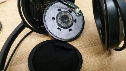

Hello,  I wanted to do the resister mod for my MA900 but couldn't find any instructions.  I'm sick today, couldn't sleep all night so here's my take on the mod.
Remove pads to access the five small phillip head screws.  Eventhough this is a single entry cable, you will need to open both sides.
Remove the bezel or ring holding the driver (Thing in background).  The driver is suspended by the grill with just one tab and peg.  Top of picture.
The grill wraps around the back of the driver.  Remove the grill just like removing the pads.
