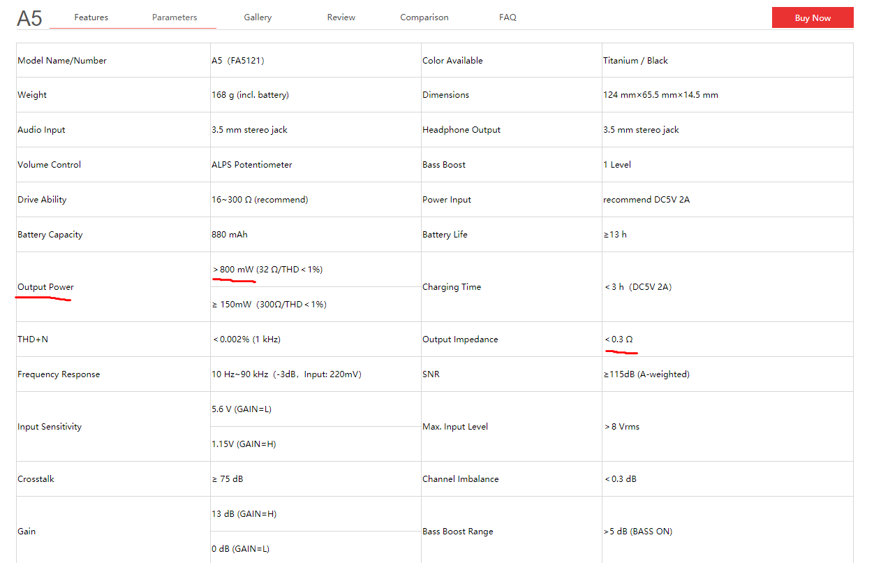

I say no, the A5 is actually a more powerful amp than the Q3 and also has much lower output impedance. So the Q3 will be a downgrade from the A5.
A5:
Q3:

You are right! The difference is quite significant (at least numbers-wise).
I wouldn't have known how to interpret all the data, so thank you very much for your help.
I have another question though (I am still learning, so please bear with me): is it only "power" that matters? (assuming that impedance regards specifically to the amount of power that the amp can give). Or can I expect an improvement in sound given other parameters like the type of amp (new and better technology perhaps)?. I read somewhere that the Q3 has a THX AAA amp (no idea what that means). I wonder how "outdated" a headphone amp can be. I have gotten accostumed to how smartphones or computers, for instance, are quickly outdated due to new technology. Does it work in a similar way in the portable headphone amp world ? (or at least in this case).
