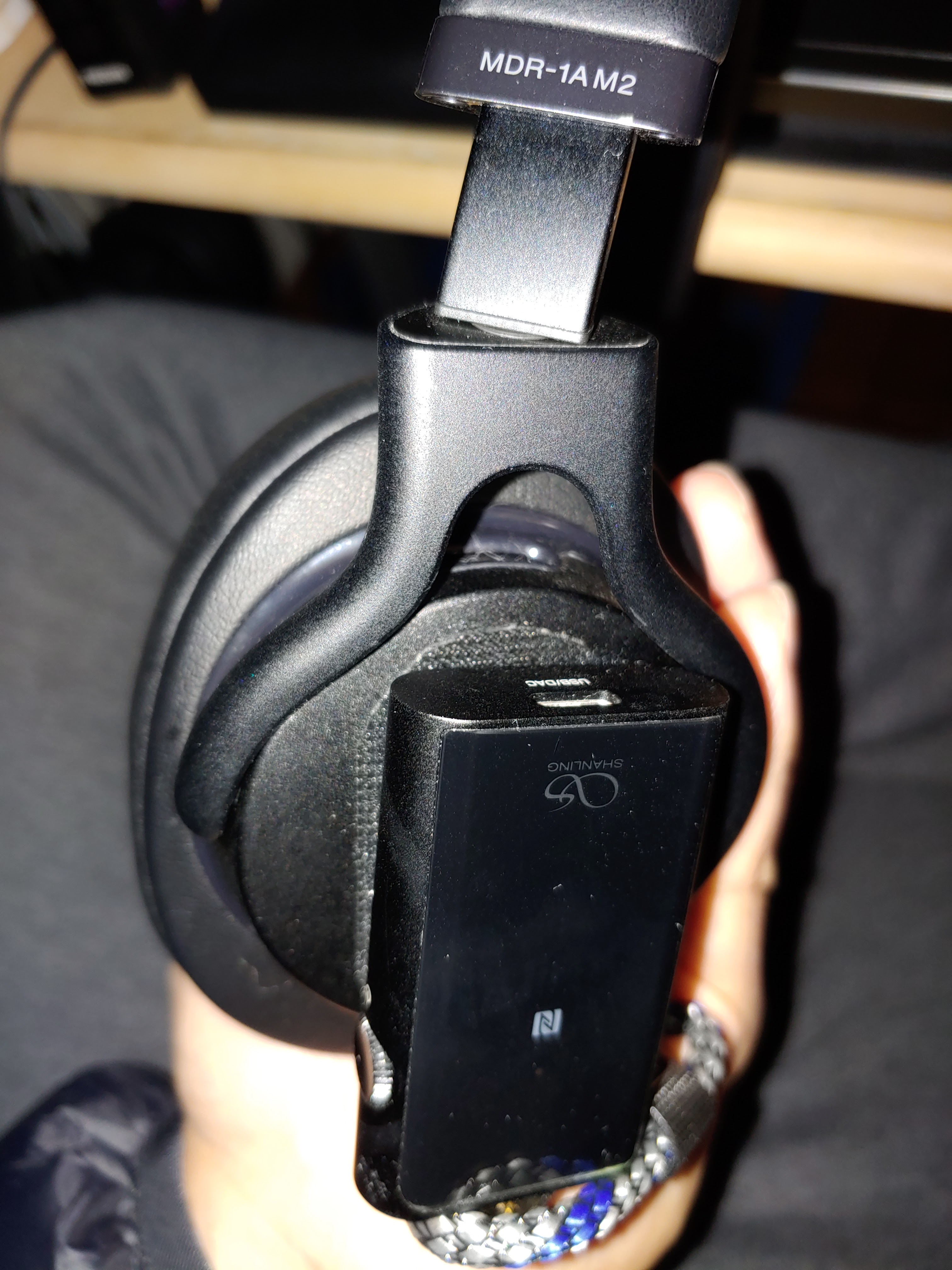

Same for me, it was useless before the firmware update. My only issue is that the battery indicator is not accurate, half the time it doesn't feel like showing me the charge % if its even correct. And for some reason the dual dac mode option disappeared after the firmware update. But at least we're moving in the right direction.
I own both the BTR5 and the Shanling UP4. I have a custom audio system in my car and all music comes from my phone, I use the BTR5 because the car mode feature is a necessity and makes it very convenient for me. If Shanling added this feature they could be alot more competitive because in this market segment there are only a small handful of options with Fiio being the most reliable choice.
The BTR5 is Shanling's main competitor, everything is comparable in terms of sound, different signature but I wouldn't say one is better than the other, they're different, sometimes you want chocolate, sometimes you want vanilla. In terms of features though and app working properly, I would say Shanling needs to step up their game.
I prefer using the Shanling though, I love the volume wheel and the shape makes it easier to velcro it to the cup of any headphones. Have it connected in balanced, sounds great.
