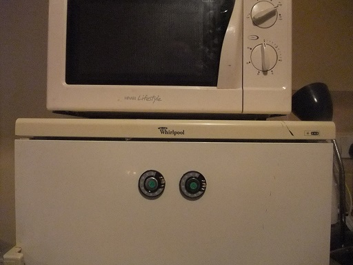

And If you don't like to waste things you now have a couple of fridge magnets !
