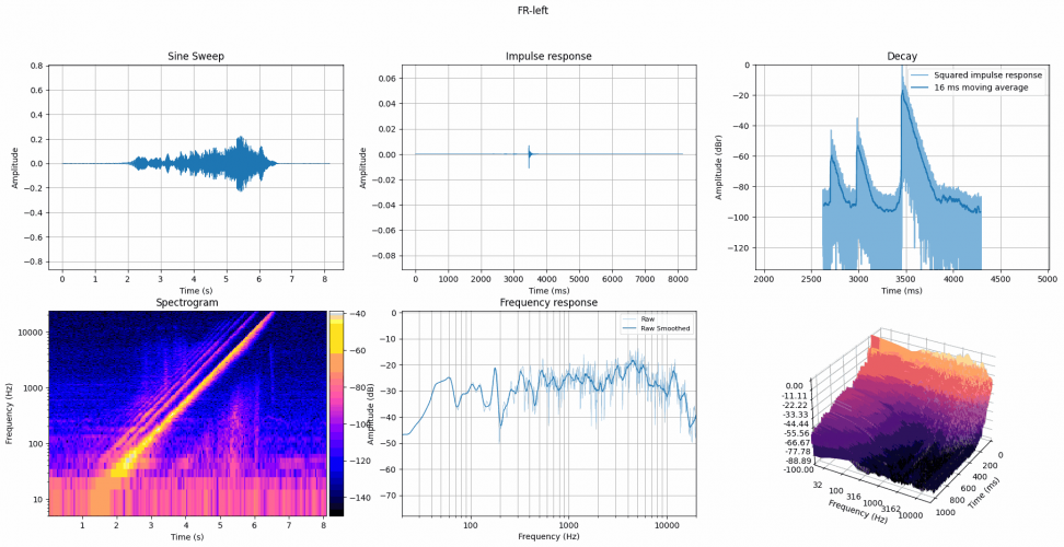

Is it Possible after the measurements are taken to increase the volume in say the rear channels? My measurement sound better than Atmos and much clearer. But Atmos rear channels are better where as my measurement sound better in everything else. Watching first flight where there's a fly in the rocket with them, using Atmos it sounds like it behind me buzzing around where as in my measurement its not so distinct. also when people are talking at the funeral the sound is more around me rather than mostly in front.
I hope someone can look at these measurements and check if I done everything right. Or if there is something I have overlooked.

Sep 9, 2021 at 7:27 AM Post #589 of 2,033
You could increase the volume in HESUVI for side and rear channels.
I’ve tried that but it’s not as good with rear pinpointed sounds. Like it’s there but not accurate just messy over there somewhere.
This is my layout and how I take measurements almost to scale 😂
Wardrobe behind me, circle is me, square is speaker
Does the echo from the cupboard behind me make a big difference to my measurements when recording? Should I hang a thick duvet to dampen the sound. I think the echo or bounce of being so close is messing up my rear recordings
Sep 10, 2021 at 7:51 AM Post #590 of 2,033
Still getting more rear detail from the other hesuvi hrir’s and on my measurements I’m getting more details from the front speakers.
Can anyone explain what I am doing wrong. Is it the headroom difference causing this?

You shouldn't change the volume between different channel measurements or the channels will end up with different volumes and you definitely don't want that.
Are you measuring with one, two or more physical speakers?
Sep 10, 2021 at 8:06 AM Post #592 of 2,033
One speaker, I can use two if that makes it better
my best measurements I have done so far is without changing the volume but keeping it so each headroom is the lowest. But they vary between 5 and 1 headroom
could it be the placement of the speaker that can cause issues. Because at the moment I’m turning my head and kind of guessing the poisitions to be looking at.
Sep 10, 2021 at 8:42 AM Post #593 of 2,033
It's really hard to say without knowing more. Maybe it's simply an issue of bad speaker / room / placement and the reason why front channels sound better than HeSuVi HRIRs is that front doesn't work well without personalization
so even sub-optimal setup is better with personalization than off the shelf HRIR.

I think that the headroom is just the peak volume (please correct me if I'm wrong). So even if just a single frequency have more power due to reflections of the walls it can cause a different headroom for your measurements although you move your ears only a few centimeters.
is having equaliser apo, vb cable and hesuvi already installed causing problems when taking measurements. Or are they not in play when the sweeps are played. Should I remove these before taking measurements?
Impulcifer uses the default sound device. You should be sure not to use HESUVI/EQ-APO for the sweeps as this would also process the sweeps. If you have installed EQ-APO only for vb cable you can just switch in Windows to your soundcard/Interafce as default device for the measurements.

You don't need to uninstall, just disable HeSuVi (and if you have other filters in EqualizerAPO configs). Any good speaker is good for recording binaural room impulse responses. For example Genelec 8351B is a very good speaker.
