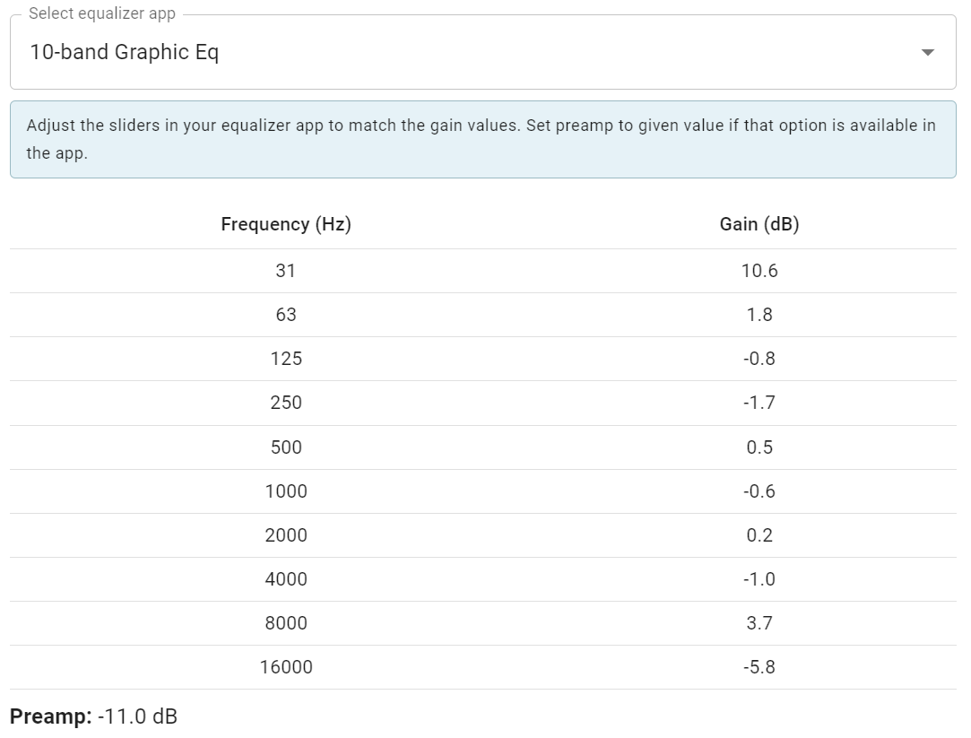

Alright so I recently picked up a Soundblaster G6 after looking around a ton. Mainly got this for playing on consoles which are a pain in the ass with headphones. After the recommendation from a friend, I decided to try the Harman Curve by Oratory. I have the Sennheiser HD600. Part of his recommendations are -11dB Pre-Amp gain.

First, I personally would not boost a HD600 by 10dB at 30Hz. You're going to add a lot of distortions (when listening loudly) while really not getting to hear much of the boost itself. If you enjoy more bass (which for gaming is a double edge sword, it pulls us in but only reduces our ability to locate things by ear), I would suggest boosting somewhere in the 50 to 80Hz area where we're more sensitive and most of the boom boom content is found. For the same amount, 80Hz is felt more, but then I personally dislike any boost above 100Hz, so I either have another EQ point to counter the 80Hz boost above 100Hz, or I just boost around 50Hz with a Q that goes down to almost zero near 100Hz. Anyway, that's entirely personal, do whatever you enjoy.
So, my main idea would be to end up with maybe between +3 and +6dB around 50Hz instead, so now you can afford to lower the main gain on the EQ to -6 instead of -11dB.
To be clear, I take that type of liberty because even if you or your friend is a hardcore fan of Harman target, there is an entire paper from Harman on that very project explaining how different people will prefer different amount of bass boost(most of it was apparently explained by differences in placement and seal quality). So Even Harman doesn't tell you to get stuck on the bass boost they suggest.
Next, your screenshot shows no Q value for the filters, is it somewhere else or is it that you don't have the possibility of setting it? If you have no Q control and the creator of that EQ did, the odds are that what you're hearing is not what you're supposed to.
So maybe one aspect of the sound not feeling right is that it isn't?
Another possibility is simply that you in particular have a head that's not a good fit for the Harman target. The issue with statistical targets is that they're in fact not for everybody because we're not all clones of each other.
