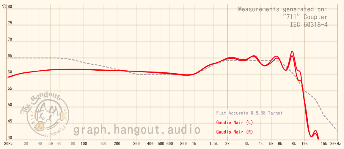

Happy to see an alternative to the very "audiophile" Harman curve. I have the Gaudio Nair and I think they sound close to your curve with less bass.
They actually do! But i am working on an update of the Target in the Bass Region right now. It is very time consuming to change anything on that target because i am constantly comparing the result with several IEM and a set of speakers which takes time. So this is the current work in progress, i am not finished on this yet and there is a big chance it will change again. So take the 0.8.38 Target with a big grain of salt.

Don't you think the above 10kHz is too dark with this target? I remember watching a can jam seminar of Knowles where they redo the research with the new 5128 rig and found that there is supposed to be much more energy around 15kHz. The old rig couldn't measure accurately up there, so they rolled down those frequencies.
