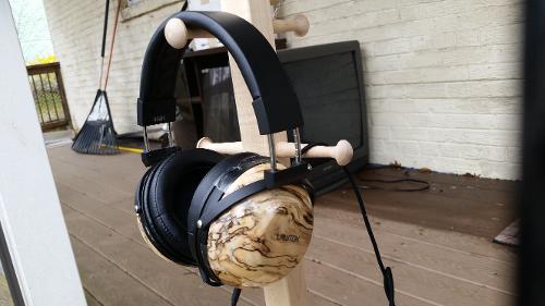

I am in the process of modding my TH900, had something to say and show, so here it is:
First, I had my stock TH900's, I love most of all the elegant sound and the bass extension into 40 Hz. Don't like the 5 KHz spike, and rather uneven treble frequency response.
Starting with that, my plans were to:
1) Recable the pair with Norne Vanquish cable,
2) Do a level 2 full Lawton Mod, with Spalted Maple cups.
However, I have not been able to get a quote from Norne yet, and my Lawton kit and cups are here, so...
ANGLE PADS
First, I tried the angle pads and compared to stock. I have to say, these are a no go for me. The subbass is almost gone, and bass in general is reduced. I didn't bother to evaluate other changes in sound since this is a deal breaker for me. I noticed the same thing happen when I previously tried the Alpha pads, so my thought is that the form factor of the these pads (covering some of the inside circle area) is mainly responsible for this effect. If this is what "tight" bass is, I'm not interested.
CUPS + Internal foam pad
Next, I went back to stock pads and changed the cups, which came with a foam pad on the inside. AGAIN, I lost the subbass, adding the angle pads made it worse. My thought was "I already HAVE HD800s!" So, I took out the foam pads and tried the cups empty - now there was a bass bloat, and the vocals were too close and harsh. Finally, I took out the stock batting material from the stock cups and used them with the Spalted Maple cups. This cleared up the vocals, reduced bass, and I finally noticed the larger soundstage of the new cups. Finally, I added the black material strips to the drivers. This added refinement to the sound, closer to stock in the subbass response, although the whole bass region is increased. While I like it very much, in this configuration the TH900 sounds like it's "bass boosted." Think of the drums in KISS's "Creatures of the Night" (which I obviously listened to - it sounds GLORIOUS!). I ran a frequency sweep and my perceptions is:
Increase from audible (15 Hz) up to 300 Hz then a drop until 420 Hz where it goes up again up to about 1700Hz, decreases until 2700 Hz and then goes up again until 5200Hz (spike), decreases until 6000kHz, then goes up until 7kHz and down around 8kHz, but truth is I don't hear these frequencies all that well anyway so someone else would have to comment  on those and upwards.
So hopefully with the Vanquish cable the treble will smooth out a little bit! I'm thinking of trying different batting material inside the cups to see if I can get a more even subbass-to-bass response, possibly retaining the vocal distance but perhaps improving the highs also. I will write here how my experiments go!
Thanks for reading, to be continued!

Boy those cups look beautiful, I want to add them to my TH600s but I use them at work, and I'm concerned they will be too flashy. However if there would be a significant sonic improvement, I could live with the flashy headphones I guess. I think if I could find a pair of good used TH900 cups for a good price I would definitely go for that.

I saw the picture of your Spalted Maple cups and it inspired me. I have ordered a pair of Asian Camphor Burls.

After much noodling, I have settled on:
Level 1 lawton mods (just the dampers on the drivers)
Zolkis/playitloud pad mod (activated carbon), removed the mesh on pads
Spalted maple Lawton cups, with a "cross" of dynamat material 2" x 1/4" inside the cups
Removed the inside batting material
Replaced the stock cable with Norne Vanquish cable (copper/SPC hybrid) - but I intend to replace this with a pure silver cable (also by Norne)
To me, this sounds quite better than the stock TH900 - and I know, because I have both. More extended and present bass, more forward vocals, clearer highs. There are some clear peaks and valleys - I hear 1500 Hz, 5 kHz  peaks and a big dip near 8 kHz.  I believe the silver cable will help smooth the treble, making my equalization even easier (I equalize my setups to neutral as possible).
I have tape on my cups because Lawton told me not to remove the screws once I screwed the cups in, as the soft wood would be damaged by scerwing them on and off, therefore I taped until I am sure I will not mod these TH900s again.
