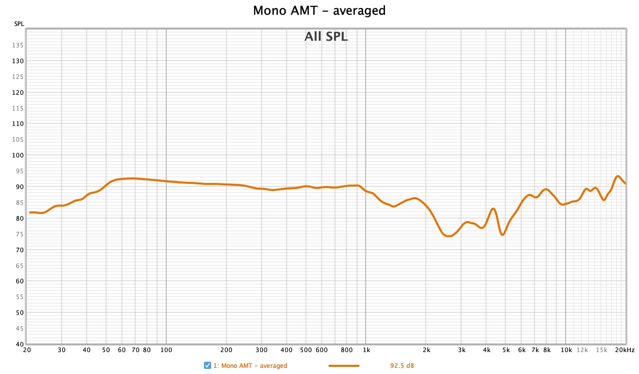

Monoprice AMT sounds like a clear tier above HE6se (modded) in every way aside from tonal balance. Tone is a highly subjective attribute in perception and preference anyway... AMT treble is laid-back tonally, however its speed and clear resolve of fine and low-level detail makes up for the tonal disparity and keeps you totally engaged. This reminds me why I wanted to get rid of vintage Stax Lambda in college, too distracting for studies.
And for the negative: does exhibit a little bit of bass bloom (air pressurization by my definition), a little less than that of Yamaha YH-1. This annoyance is partly mitigated by the unfortunate physical weight of the headphone, meaning I dont expect very long listening sessions more than an hour for Mono AMT. I just did an hour+ and decided it was time for a break for my ears and neck, however it was totally enthralling to hear new detail in music that Im very familiar with especially since the new details emerged from the full-range of bass-mids-highs. The weight strain can be compared to Audeze LCD-X, however LCD-X bass could never hit like this. For reference, HE6se has more bass impact than LCDX 2022, while LCDX 2022 is more resolving of microdetail than HE6se. AMT bests them both from my recollection (will work on final impressions and direct comparisons later).
I think the bass alone is worth price of admission. If weight and bass bloom were not a factor, then I would see AMT as a headphone to aspire to at MSRP. Despite those serious (to me) flaws, a keeper at $300.
An oddity is when attempting to measure on EARS. Not sure what to make of it but there is wide bass variance. Such variance is indicative of pad leak. Yes, the pads are huge and extend past the edges of the mic baffle but the pads are relatively supple so its hard to imagine a leak. idunno
All measures done on EARS, averaged after multiple positionings, curves intersected at 200Hz as that seems better to visualize my subjective experience of tonal differences.:

Interesting impressions. While the AMT tech is very intriguing to me, I can't help but wonder if that recessed area around 3khz would render them unlistenable to me. That area was my main sticking point with the AQ Nighthawk (thankfully, I fixed that with a pad swap). However, headphones that are relatively even in this area (no a sharp dip/spikes) even if they are lower relative to the rest of the frequency response, I'm fine with, like my M565.
I know it's a bit of a moot point since it's modded, but what generation is your T20RP you are comparing here? MKII or MKIII? I find my MKII-based T-X0 almost as oppressively dark as the Nighthawk and it has a similar crater around 3khz (I still need to get around to modding that one).
In your opinion, do you think it's the pads on the AMT causing that dip around the ear gain region or is it an interaction of the driver/housing itself?
It is polarizing. Some are more sensitive than others to this particular area. I am particularly sensitive to upper mids (approx. 3kHz) and air pressurization. Sensitivity to 3kHz region may also be partly effected by personal listening volumes (see Equal Loudness contour). For reference I find HD650 a tad too forward in the 3kHz department, I keep only as a reference.
Tx0RP mods can result in very different sounds... I am using a mk3 which I prefer over mk2 because mk3 has large front-side vents integrated into the pad mounts. The extra venting helps with air pressurization (fatigue) and helps with a quicker and more natural bass decay imo.
I've no idea, sorry. If I find anything useful later then I will make sure to comment.
I could diy perforations to stock pads to help with air pressure but I wonder what other effects it might have... Hopefully replacement pads arent too expensive. Custom ordered pads from Vesper could help but not cheaply. Im not too concerned atm with fixing ATM's faults.

As for the upper mid dip it’s big. And the distance of the “baffle” like so many headphones causes a depression in that area, but it’s more than most. If it takes parametric eq well it could solve that
I assume the bass is probably not very potent in terms of impact and EQ probably won’t save it. My mod for that would be still any “baffle” reverb and EQ it with a low shelf. If it can’t at least meet HD-600 impact/timbre levels I can’t use it for 75% of what I listen too
Aug 31, 2023 at 1:59 PM Post #128 of 412
Possibly could be hearing a combination of the effect of pressurization (and resulting bass bloom) and incorrectly perceiving as sum of bass impact imparted only by driver. I got that sense from HE6se as well when using solid pads or inner-perforations-only pads similar to Mono AMT's. With similar pads, HE6se seemingly does not have the same kick. Currently I am using HFM "velpads" pads with HE6se as it to me is the best overall without pressurization but it is a trade off as you know. Will take a closer look with full review later.

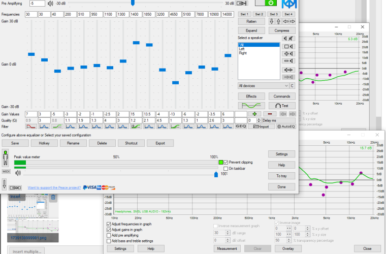

The upper mid dip is polarizing. I don't have PEQ unfortunately. I could try Lokius but its a relatively blunt instrument so probably not good for this.
Yeah you’d need a 31 band or more fixed freq EQ to have a shot at that.
