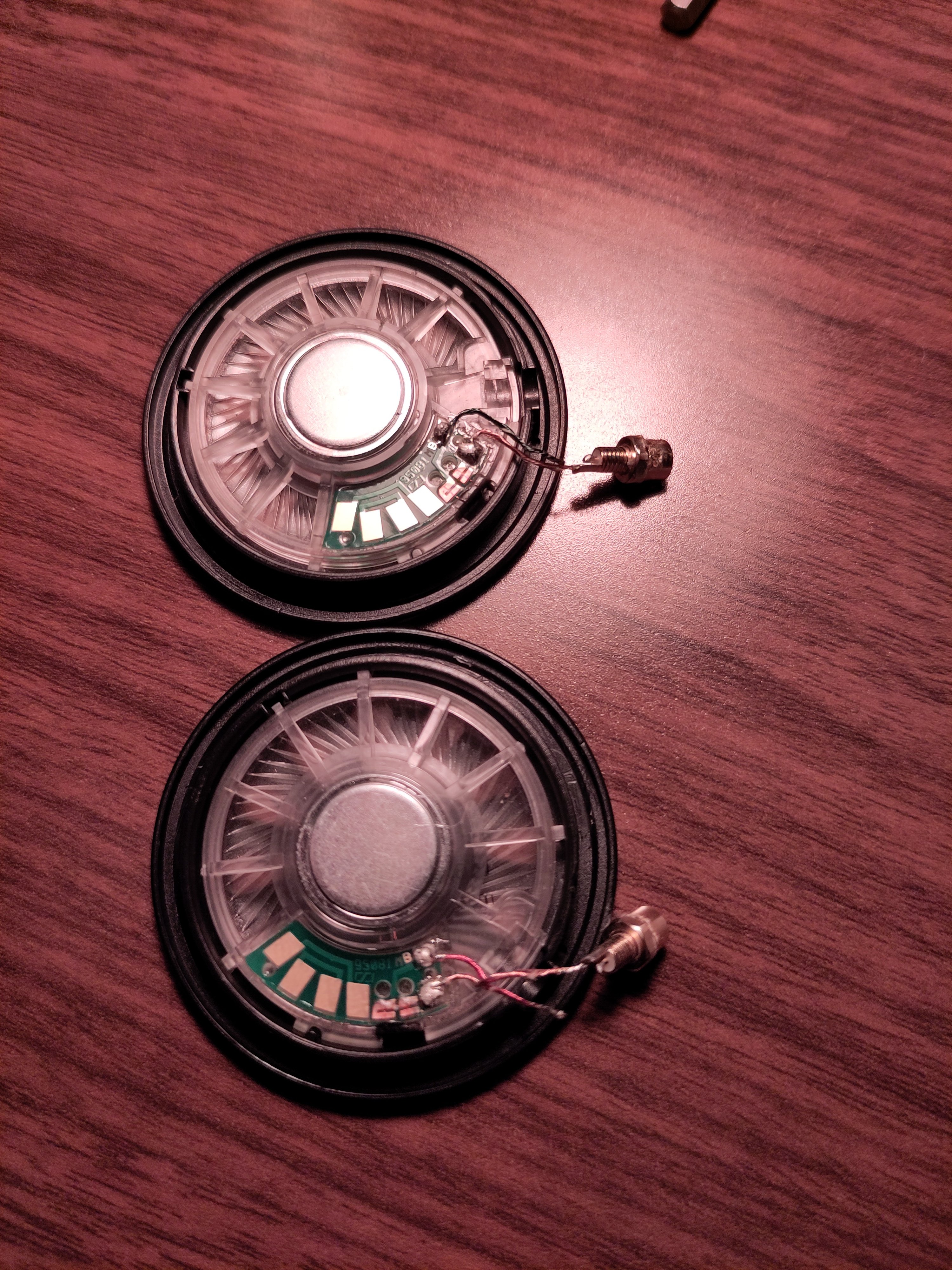

I first got some PX100-IIs used and quite liked them so I have been on the lookout for any other similar models. Snagged these PX200 on Ebay broken. Converted them to MMCX connectors today. Used hot glue to keep the MMCX attached in the ear cups. Used original enamelled wired to wire them up.
Part way through modification:
Finished set with new ear pads, headband pads, mmcx connectors hot glued in, double sided tape to join halves, pressed together and reassembled:
They don't fit in the hardshell case though with the mmcx connected when folded:
Pretty sure I like the PX100-II more as it seems like a much warmer signature and has less clamp with the foam pads. These are better for having a bit of isolation though.
