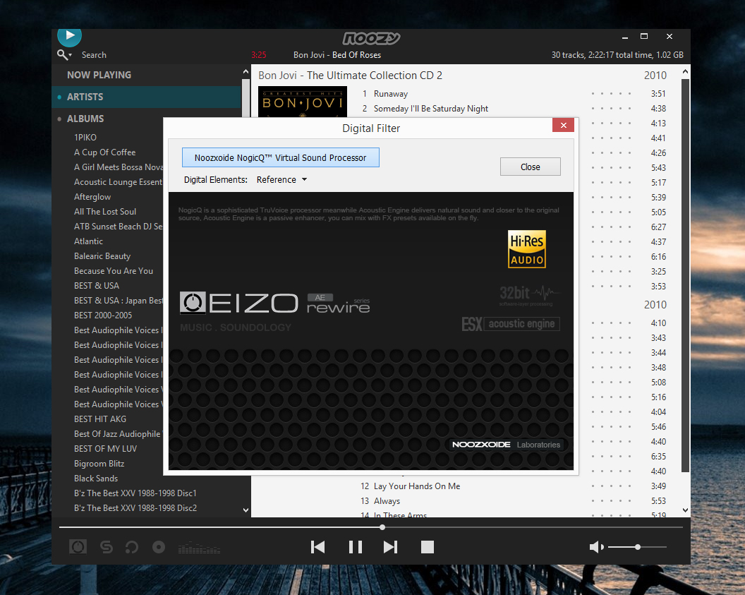

Above pictures are "noozy" high end music player for Windows platform that will release soon.
