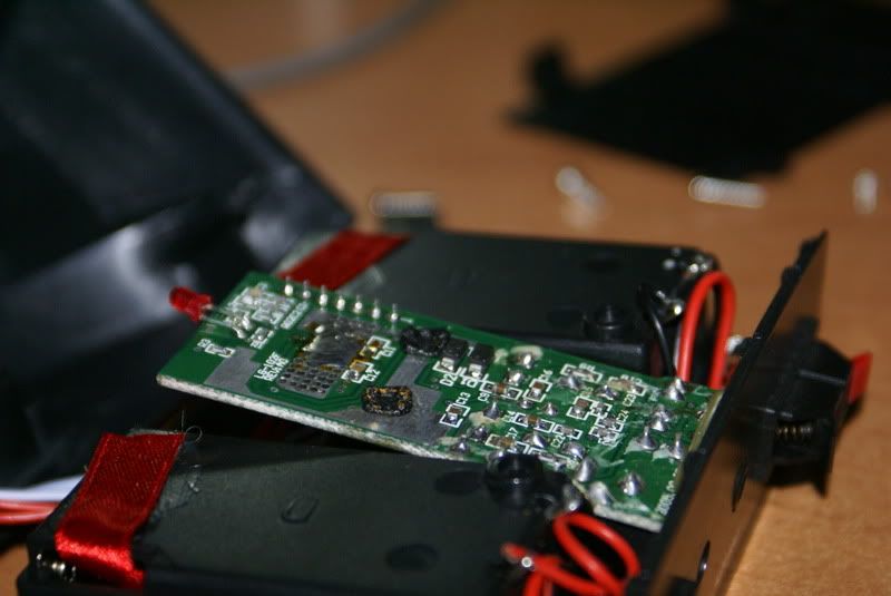

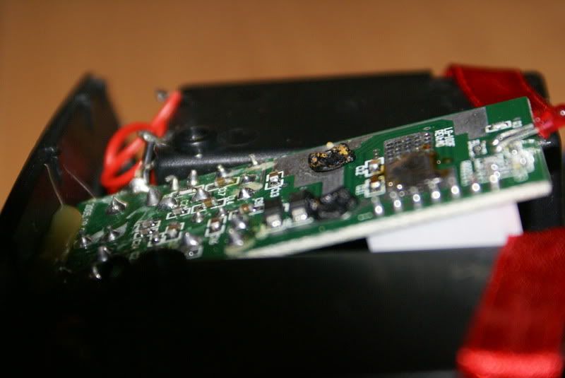

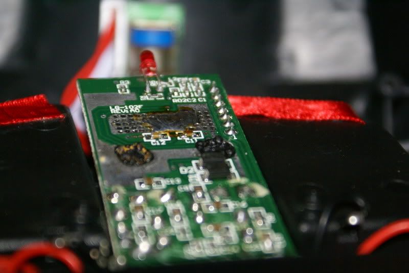

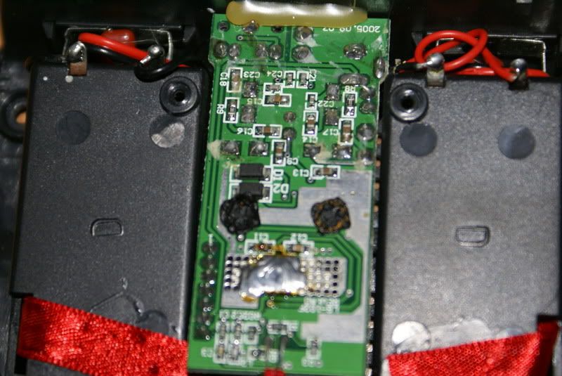

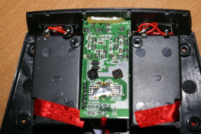

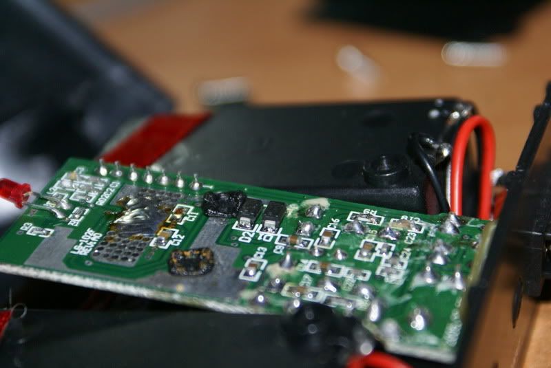

Around the end of November I bought a second-hand T-Amp in eBay US that came with this PSU. When I recieved it I didn't have any speakers so I just checked that it turned on and that's it. Then around January 2 I recieved my Insignia speakers. Connected everything and there's no sound coming out of the speakers but instead a small hiss or scratch and sometimes thumps when I play a song. But there's absolutely no sound, I've tried listening very closely and not. I checked everything, nothing. Used another amplifier and now the speakers are sounding (and very nice). So I know it's the T-amp. Then I tried it with batteries instead and still nothing. So I opened it and took a few pics to see if someone can diagnose the problem.
Any help is appreciated.
Thanks.

uh.time to start the shopping
GL!
Jan 25, 2007 at 2:42 AM Post #3 of 9
I gotta agree, it looks like it's fried pretty good. Was the adapter properly rated? If I recall (I just bought a T-amp, so this is from memory) it needs to be around 1.3 amps and 12-15 volts. Check the amp itself to see what the requirements are. I've fried stuff by using too much voltage from the wrong adapter before--something you might want to check before you get a new amp.

it could be frieds, but i think that is the back side, hard to say. what the heck are those two black dots though.
