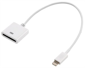

For the lightning to 30-pin, can I get one that's just has the lightning adaptor, like this:
http://forums.macrumors.com/attachments/30pin-jpg.435389/

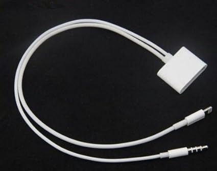

 ...or do I need to get one that's lightning + 3.5mm on one end and the 30-pin adaptor on the other end, like this?:
http://ecx.images-amazon.com/images/I/410MMDiNPmL._SX425_.jpg
I could probably grab one of each since they're so inexpensive, but no sense in grabbing the one w/ the 3.5mm if I don't need to.
