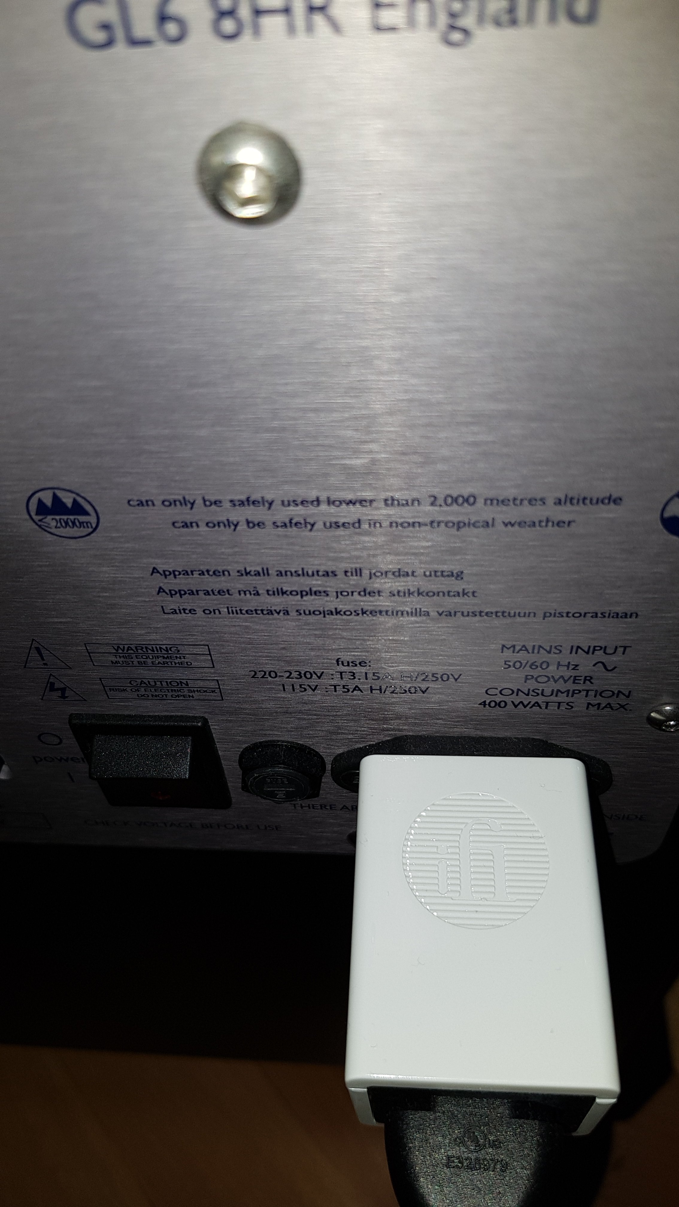

I received the DC Blocker today, unfortunately did not remove the noise, as the Naim Uniti Atom HE is brand new and could be faulty. I will take it to the dealer for a possible evaluation and unit exchange.
I have to add that the DC Blocker is a very convenient solution, connecting it in the end of a cable is an impressive design.

Just an update, the Uniti was considered defective out from the box by the dealer. It will be exchanged for another.
