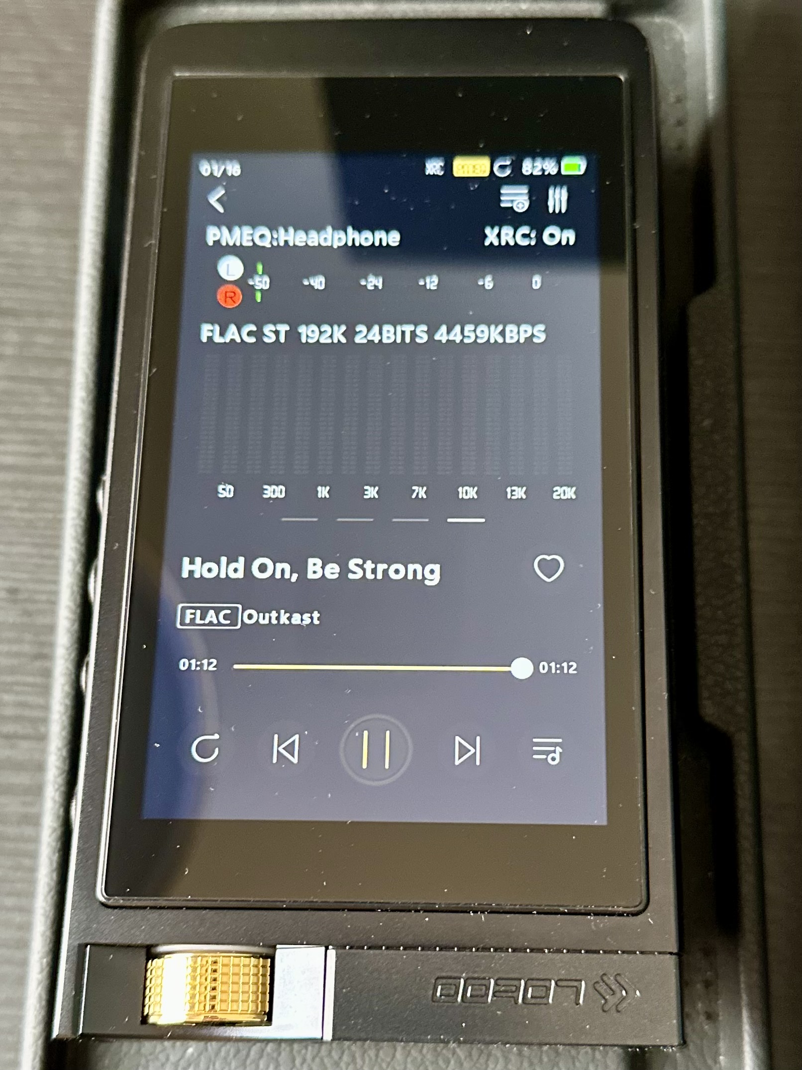

Can someone with a GT2 nearby do me a favour. Can you insert any cable - IC or headphone cable or even an adapter - into the 3.5mm plug. Can you please then go to settings, and choose "line out" as output type and "unfixed" as the line out option. See below. Taking any headphones off, can you then adjust the volume dial and tell me what happens? Thank you.
Apr 18, 2025 at 5:08 PM Post #260 of 276
Yeah, I just did this and it says "volume not adjustable". Unfixed LO only works with 4.4mm out.
Apr 18, 2025 at 10:53 PM Post #261 of 276
Thanks. Good to know it's only a software issue. I've told Lotoo and hopefully they'll FW fix it soon.
