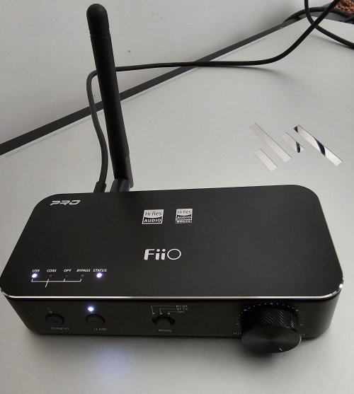

So, I've decided to test the GO Pod with my FiiO BTA30 Pro. I bought this abandonware long time, ago. Never use it.
It works well with the GO Pod, listening to LDAC, as it can been seen in the photo (white status LED).
As long as I am in the same room, everything plays fine and the Bluetooth connection is stable. Kind of the same when I'm on the same floor, in my property.
If I will go upstairs, though, the connection can be lost, something I'm not facing with my S23 Ultra.
One inconvenience is that, when the Bluetooth cuts off, I need to power off and on again the BTA30 Pro, for both ear loops to play.
This is entirely BTA30 Pro's fault. Only Vol Up/Down and Play/Resume works, again, entirely BTA30 Pro's fault. No worries, it is an abandonware I almost never use.
I've listened to YouTube Premium and Amazon Music Unlimited, also watched some Disney+ and Amazon Prime Video.
With my 7Hz Timeless everything sounds great to me.
Good to know it, basically, works.
