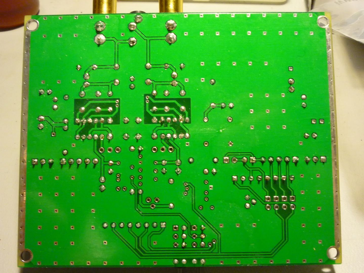

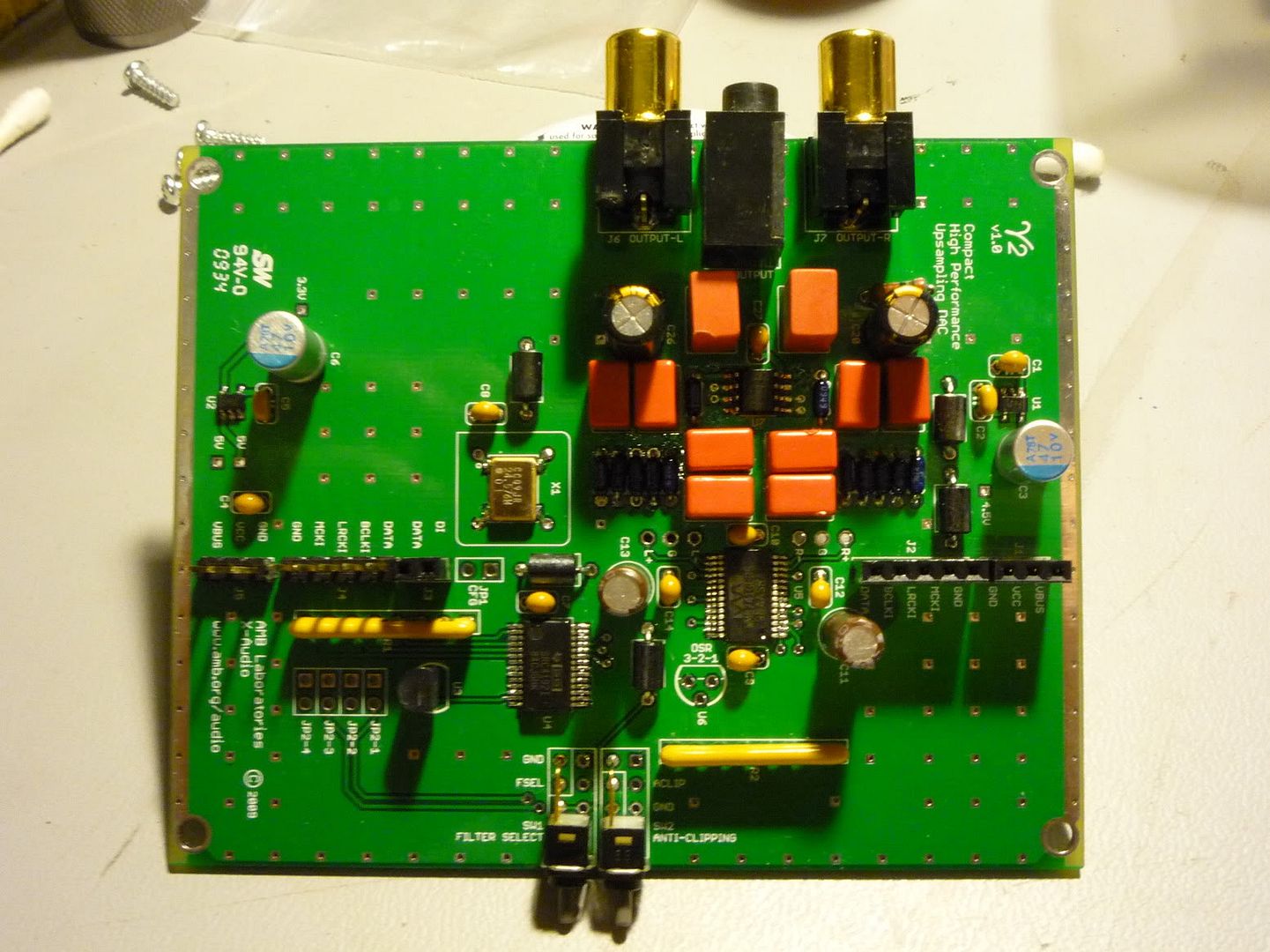

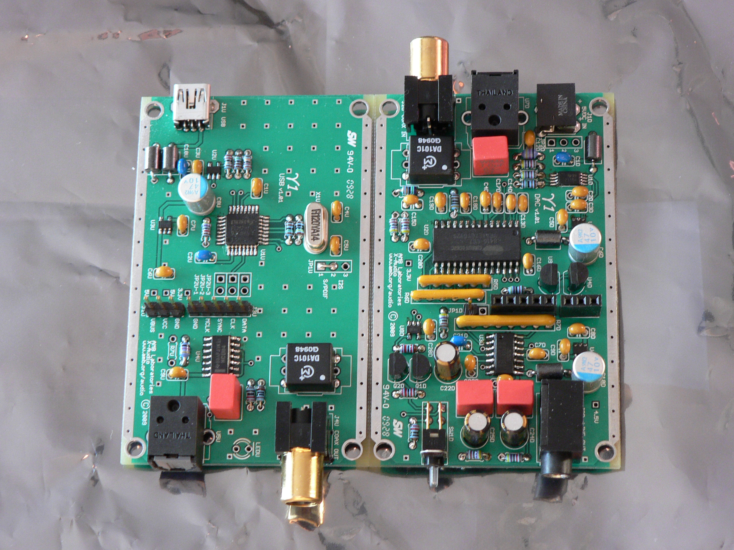

Hi guys,
I finished my y1 full++ config earlier in the night and it's working great (tested optical and USB) after I tracked down bad joint in U2, however my y2 board doesn't seem to output any sound. The y1 board works independently and when mated with the y2 board, however when the boards are mated, I get no sound out of the 3.5mm jack on the y2 board (3.5mm jack on the y1 still works--are these supposed to work simultaneously?). I reflowed most of the points on the bottom of the board. I also reflowed U4, U5, and U7 twice with no luck.
Voltages with USB power (I don't have a separate PSU suitable for this at the moment):
3.3v - 3.29
5v - 5.01
4.5v - 4.72 (TPS793475)
Any ideas on how I can narrow down the issue?
Pics:
(sorry for the poor photography--not my specialty)
Jan 29, 2010 at 8:31 AM Post #1,376 of 2,154
Volkum, did you install the correct part in U3? Should be a MCP100, not MCP101.
Other than that, use a loupe or other visual magnification to inspect for solder bridges between IC pins, particularly U4 and U5, and check the joints at X1.

U3 has MCP100 installed. I'll give those components another look over tomorrow or Saturday--I've looked them over so many times tonight that I'm possibly cross eyed now lol.
Feb 1, 2010 at 4:12 AM Post #1,379 of 2,154
Originally Posted by francisdemarte /img/forum/go_quote.gif
I had a similar issue and it was X1. I had a hard time getting a good joint and not shorting it out.
It was X1! Woot!
