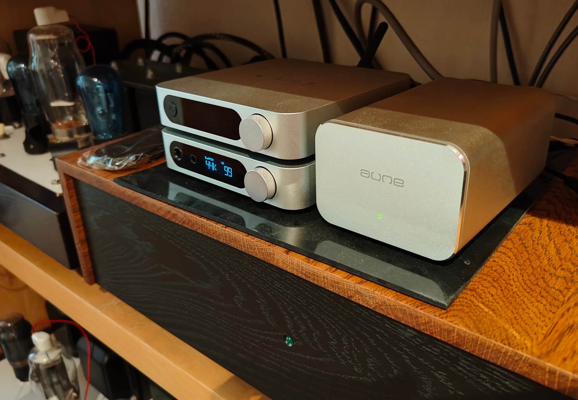

FiiO K11 R2R DAC + FiiO SR11 DLNA mode streamer + Aune XP2 linear PSU.
Very good sounding components 👍 👍👏
