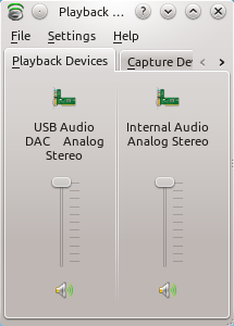

Anyhow, here's a snapshot of what my kmix audio settings display on ubuntu:

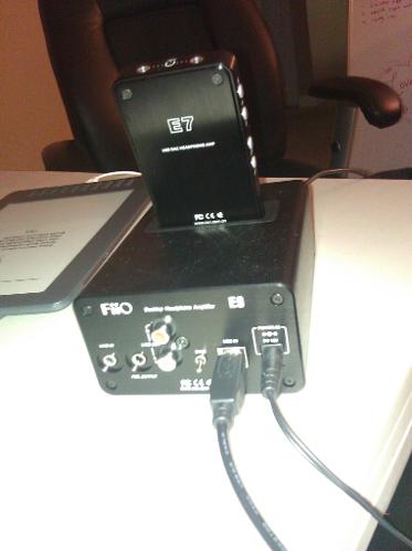

As you can see, it's set as the master channel, and the volume is all the way up. The way I have my actual E7/E9 configured is that I have the USB cable plugged in (obviously), the E7 docked, turned on, and the E9 turned on as well. My headphones are the only things plugged into the front of the E9, and on the back of the E9, the only thing plugged in is the power cable and USB cord.
Here's what it looks like:
