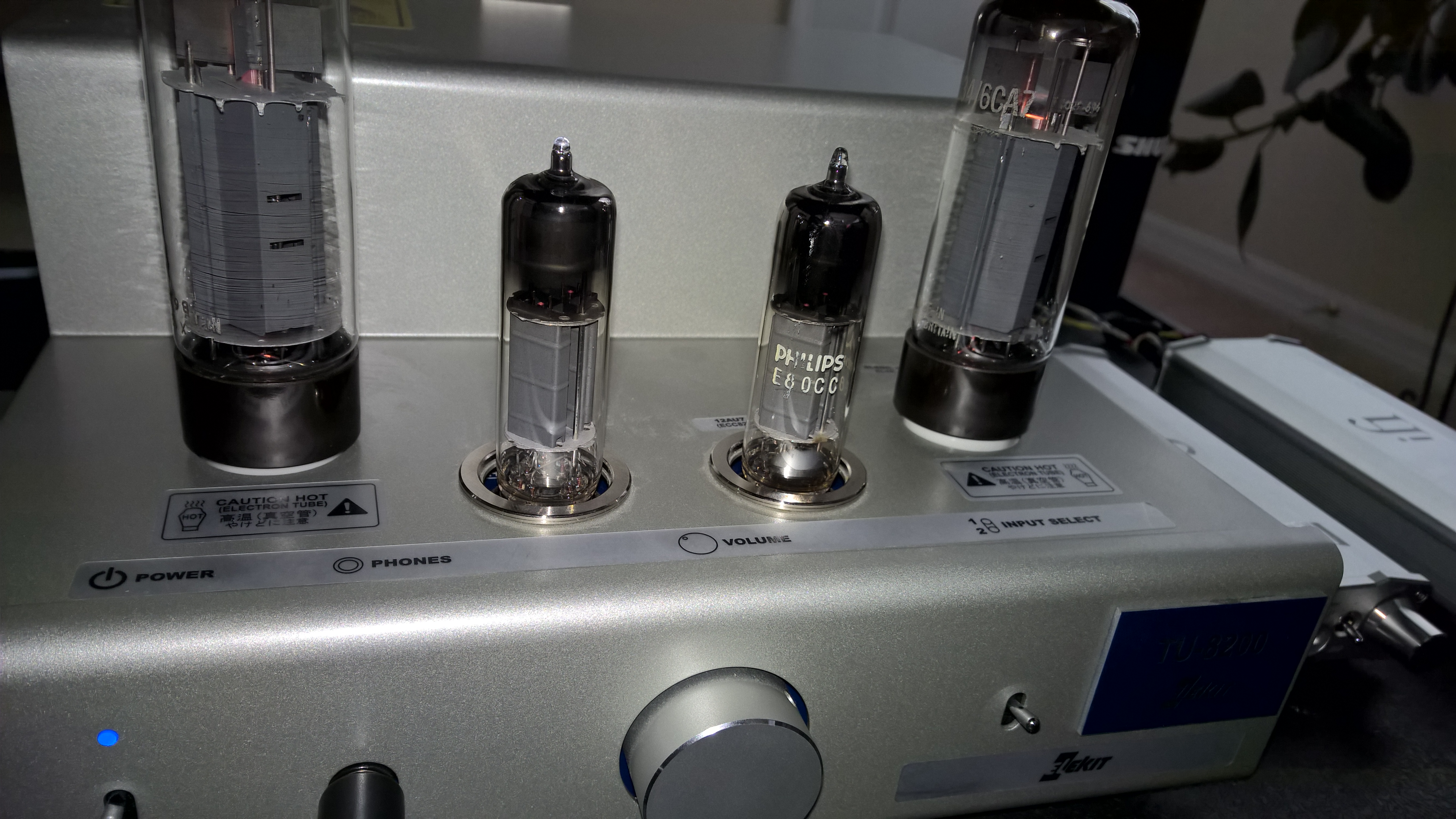

    WP_20170905_18_15_33_Pro.jpg I just got a package from Belgium today with a pair of Philips SQ E80CC/6085 tubes that I bought from eBay last week at a reasonable price. This is indeed a different animal in this amplifier and this Heerlen-made tube from Holland sounds like the best 12au7 on steroids. The sound is very clean, dynamic and transparent yet still tube-like and not solid state but rich and pleasant. The first impression I immediately got was the sound became 'quicker' and not as laid-back or lazier as before with the GE 5-star ones, still the 5-star ones are best overall for me.
    6085 are really interesting tubes to compare against the 12au7 types. The volume is a bit louder too because they have a higher gain which is not a big deal. I have an impression that they are so revealing that perfectly-recorded tracks sound better with them but poor quality ones sound even worse. The instrument separation is noticeably better and the music has become slightly more 3-d.
    I am still a bit nervous to keep the amplifier running them for longer periods of time because they demand twice more current, however, after about an hour, the sound is still the same, no smoke or other malfunction symptoms detected from the amplifier which is a good start. I hope this amplifier will have the reserve to run them (fingers crossed).
    I have settled on the Mullard EL34 X2F for power tubes and those are taming the highs a little bit. With other power types, like KT88 or military grade ones it would probably result in a fatiguing experience at the end of the day. Even matched with the EL34s - it may be a bit overwhelming for some types of music to listen to for a longer time, I am afraid.

    Is it safe to use e80cc + el34 witch stock transformer and stock part?.. or I must upgrade some part to use that tube..
  12. lucidreamer
    I am running E80CC with stock parts (actually a DX version with upgraded capacitors, resistors, etc.). So far it is ok but only time will tell. Like I mentioned earlier the stock DB107 diodes are rated at 1A and should be fine to drive these tubes. The power transformer is also pretty beefy and is 250va. An extra 2w of load should not do anything to it, there are tons of posts on this site where people run those tubes with smaller amps and did not blow them.
    But to be extra safe - you can upgrade the DB107 diodes to something like 2A and also upgrade the power transformer to a bigger one that can fit in the case which would be a challenge and a significant expense. I would not bother doing that if it were me.

    Get a bigger rectifier for preamp heater supply so that you can run E80CC with smaller power tubes. Then get a pair of Dutch E80CC. Unfortunately this is where meaningful tube upgrades end because you can only mix E80CC with 6L6GC or 807 tubes using stock power transformer. Still, upgraded rectifier with E80CC and good 6L6GC or 807 is the best sound you can get out of stock transformer- much preferable than 12AU7 with any power tubes (I tried pretty much everything worth trying other than TungSol 6550). I would recommend Cossor 807, RCA 6L6GC black plate or GE 6L6GC. Sylvania is ok too. E80CC has twice the plate size of 12AU7 and consumes twice the heater current and that does make a difference.
    I've been listening to E80CC and Cossor 807 from 1950s before I swapped out power transformer to a bigger version. I could hear difference with the bigger transformer right away (I swapped transformer for more heater current, but I guess bigger core influenced signal power as well), but more importantly it allowed me to install power tubes with bigger heaters while retaining E80CC. After some experimenting I ended up using for months Telefunken EL12 spez made in 1960. Today I swapped 807 back in and it is clearly lacking, at least to my taste. Put GEC TT21 in there- better than 807 but still lacking compared to EL12 spez (TT21 is GEC KT88 with top anode for higher voltages). Then swapped in GE 6550- similar sound to TT21. Next came Mullard EL34 XF2- this was closest to EL12 spez sound of all the tubes I tried today. So I gave up an popped EL12 spez back in- feels like home again. Another bonus with EL12 spez is that amp runs very cool- huge difference relative to bigger tubes. Those Mundorf caps will sure be more comfortable than with bigger tubes that overheat the amp.
  14. Dimu
    If you do that you will overload preamp heater rectifier and you will overload the power transformer. Rectifier might give you unpleasantly smelling smoke at some point, but transformer overload consequences could be more interesting. The question is whether amp's 3A fuse will stop really bad things from happening after transformer coils fail due to extended over current operation.
    Upgrading rectifier is trivial and costs just couple or three dollars. Upgrading power transformer is a project. So you have two easy choices:
    - EL34 with 12AU7
    - 6L6GC with E80CC and upgraded rectifier
    I would go with the second option.
  15. Dimu
    Please don't confuse people with conclusions based on bad math- not when it comes to safety. E80CC is rated at 0.6A current. That is nominal rating, actual current draw can be higher than that. And you have 2 tubes. So you are definitely looking at more current than what those rectifiers are rated for. DB107 has maximum sustained current rating of 1A at 25C ambient temperature. Temperatures inside that amp go much much higher than that, especially if you use big power tubes. So you are over temperature and over current, both by unhealthy margins. How does that qualify as "should be fine"?
    What do you mean "pretty beefy and is 250va"? How is that going to compensate the fact that having 1.2A rectified plus 3A RMS current far exceeds the 6V secondary rating of 4A? Elekit recommendation is to allow for twice the current on transformer end relative to what rectified current is for the heaters. Also for your information, a properly designed transformer to accommodate those extra heater amps requires "beefier" core than the stock transformer.
    And where do you get 2W? Power leaving that transformer coil is much more than 2W over rated power if you use E80CC and EL34 together.
    When you say "extra safe" you are implying that if you don't do those things you are "reasonably safe". This is obviously wrong- bad conclusions based on bad math.
