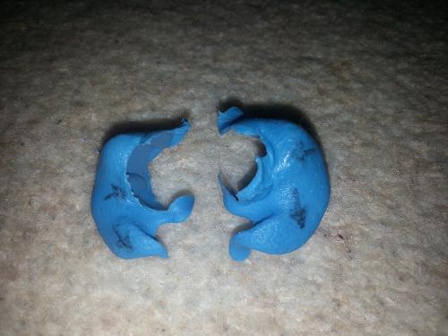

I did it :)
after a few not so good attempts, i refined my technique to the point where i can make a custom mould for my ear,
for any iem,
get a perfect seal,
and incredibly comfortable.
for less then $2 a pair!!!!!!!!!!!!!!
a 1/2 pound of easy mould cost me about $27, and i can make 20 or 30 custom moulds with it....
http://www.amazon.com/Easy-Mold-Silicone-Molding-Casting/dp/B003CHMZXI
maybe not as pretty as *real* $250 custom moulds, but having the ability to make a custom mould for
ANY iem i own
is  priceless.
as you can see, my inner ear canal is very small and not uniform
http://i41.tinypic.com/124vnrc.jpg%5B/IMG%5D
these diy moulds give a PERFECT seal and are so comfortable i dont even know i have anything in my ears.
i used this guys technique as a guide... but i found that forming the soft putty into a longer thinner cone shape and then inserting into my ear made my moulds have much better isolation (perfect seal every time)
http://www.youtube.com/watch?v=lmk-y_9exJ8
they end up looking like these with an iem sticking out the side
http://www.radians.com/main/p-282-radians-custom-molded-earplugs.aspx
Mar 11, 2012 at 2:37 PM Post #3 of 89
seriously, i know some will say "not possible" (but the wright brothers got things to fly, we can get modern silicone putty and an iem to 'sit right')  these things fit and sound awesome, for $2 a pair.. custom.
http://www.amazon.com/MEElectronics-M6-CL-Sound-Isolating-Headphones-Players/dp/B0038W0K2U
it will cost you $27 and some time (not much time, the putty dries in 5 minutes) to experiment with making a few pairs, after that, you can make custom fit moulds for all the iems you own,
for the rest of your life
for $2 a pair :D :D

Man, this looks interesting! What does the material feel like when it has dried, though? In the pictures, the shells look like they could be a bit uncomfortable... (I'm hoping to find something that could make a more rubberized consistency)
Mar 23, 2012 at 10:05 PM Post #14 of 89
its pretty flexible and soft ish when dried, its silicone, so its like a silicone tip only a lot more of it, very comfortable.
