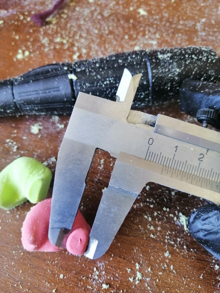

(Drivers, Soundtubes, Dampers, Shells, Connectors.)
Finally get to listen to these CIEMs

UPDATE 31/08/2012 Pt.2:
Alright, Here's some pics of the CIEM w/o Faceplate:
Add Fix Faceplate on shell using general purpose glue.
(Faceplate is made of Glossy Heavyweight paper.)
Then incase the faceplate in epoxy resin, apply using syringe.
