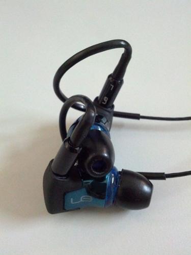

OK they aren't exotica cables but I have to say they are pretty cheap.
I had them made to custom with the pins and splitters and Neutrik L, yes they were made in China.
The first one I had made were 'Athena' cables, I originally thought they would be thicker they are meant to be 8 braided flat, original colour should of been copper but I asked for them to be sheathed in black wrap. I have no idea what type of cable 'Athena' are but they are about a 32AWG in my reckoning, don't know if they are SPC or what. All I can say they are very clear sounding, I have them on my SF3 which I find extremely good.
The UE pins are gold in colour the earloops are moulded using heatshrink which are absolutely fine, the splitter is an aluminium tube which is hot glued for strain relief. Microphonics are non exsistent it is soft and supple, only problem is the thiness of the entire cable. It's a minor niggle but I am very gentle with my stuff, the Neutrik is great. $23 is better than the OE cable.
Next up after a couple of failed attempts of trying to DIY a cable for my TF's I decided on the interim to purchase another set made by the same place, this time with 'Vienna' cable again I asked for the same setup black wrap and splitter, but this time they gave me black UE pins which I have to say is a bonus.
Sound wise the 'Athena' seem to bring the highs out whereas the 'Vienna' most definitely bring the midrange and bass.
The 'Vienna' is also a bit thicker and coil resistant, but also has almost nil microphonics. Overall it cost me $33.

Those pins for your TF10 cable are meant for the CIEM's from UE. They probably have stretched out the internal pins of the TF10. Not familiar with which pins were used on the other one or what size the internal pin receptors are on the SF3.
Looks nice. 32 AWG is really tiny. Would be nice to know what it actually is. You're quite far away from any normal size (normal size seems to be 24 AWG, 26 AWG, and I've even heard of some 28 AWG aftermarket cables). Probably a good idea about the sheathing. Would've been really fragile if they weren't protected like that, and if the cable really is that thin, it probably didn't add much to the overall thickness. From the photos it seems quite hard to imagine their are 8 cables in that wire, even at a really tiny thickness. Most important thing is you enjoy them though, so glad you enjoy them. Can you please tell us what the name of the company is? It's adding a level of vagueness that can only discredit your post by not including them, especially since Sun Audio makes a cable that goes by the name of "Athena" that is specifically only meant for the UE type pins you would have on your SF3's and TF10's. Where'd these names come from if they are both custom cables?

Those Pins/Connectors pictured, are for TF10's and not CIEM's.

Interesting. I thought they were in fact for CIEM's. Gotta check some things then, may have ordered a wrong part. What's with not being able to find the right pins for aftermarket cables? Such a hard task.

I am not a great fan of Chinese QC the gold pins are a tad tight into the SF3, but slip in my Altec UHP336 and TF10's like precision.
The Black pins fit all, maybe my SF3 are just tight! I've read that TF, SF and UHP are 0.75mm and CIEMs are 0.78mm, so far absolutely no complaints on my part.
