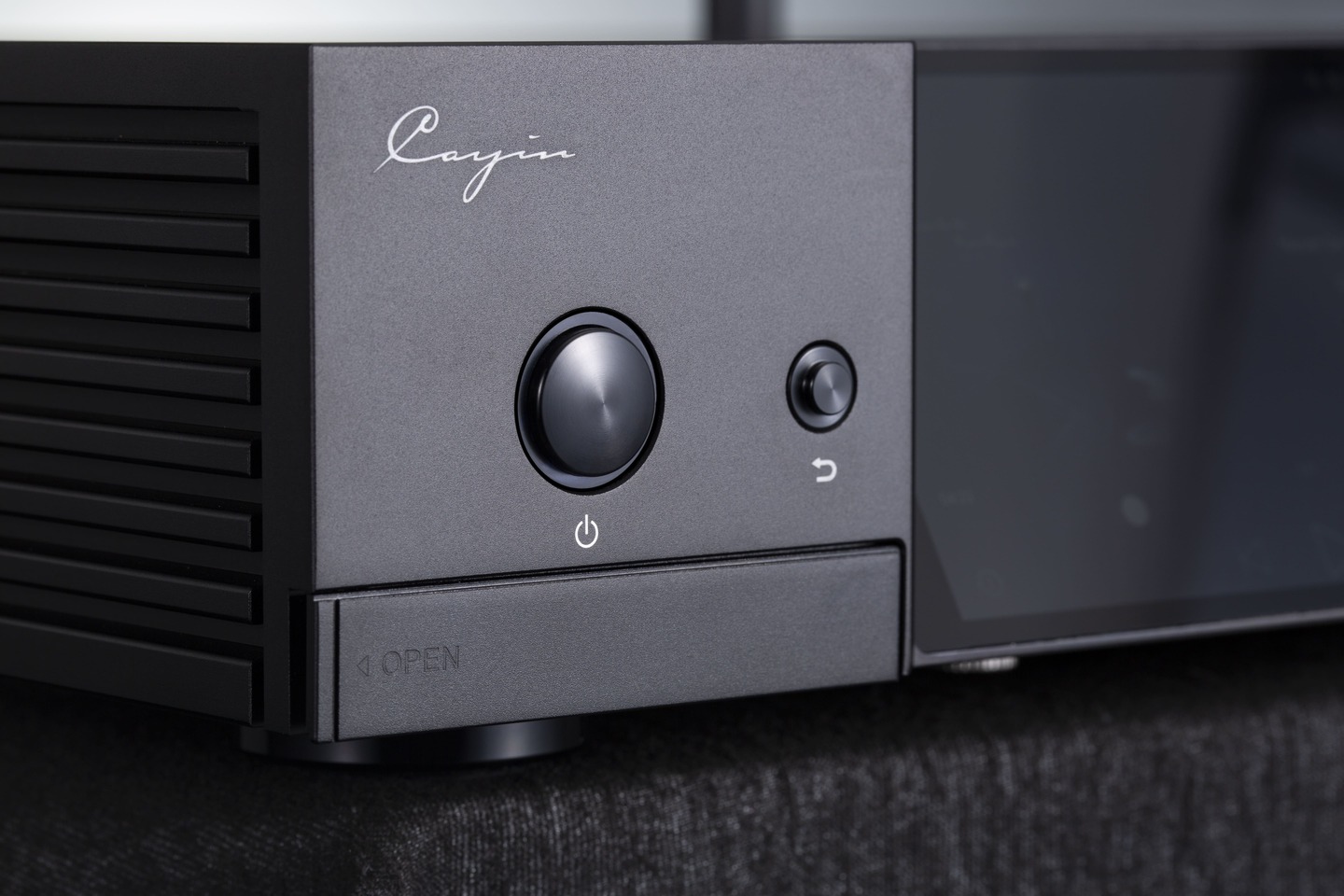

The Cayin iDAP-8 is a standalone Android 9.0-based music streamer with Google Play pre-installed. It does not include any DAC or analog audio circuit.
The Cain iDAC-8 is a dual timbre DAC with two AK4499EN in mono mode. It can also function as a preamplifier.
Features and Design Considerations of iDAP-8 Network Streamer
  1. Features a 5-inch Full HD (1920x1080) TFT display with touch control and landscape orientation.
  2. Offers 6 different digital output interfaces:
    • USB Audio (USB Type A) x2
    • I²S (HDMI Type A)
    • AES/EBU (XLR3)
    • SPDIF Coaxial-BNC (BNC)
    • SPDIF Coaxial-RCA (RCA)
    • SPDIF Optical (Toslink)
  3. Supports a 2.4G/5G WLAN (WiFi) wireless network.
  4. Supports a 1000M/100M/10M LAN wired network.
  5. Equipped with 2 USB 3.0 type A female connectors (one on the front panel and one on the back panel), supporting playback of music files from common USB storage devices such as thumb drives, portable hard drives, and card readers. Both USB interfaces support USB Audio output.
  6. Features one SD card slot, supporting up to 1TB SD/TF cards for music playback and firmware upgrades.
  7. Features one USB 3.0 type B female connector for connecting to a computer for file management.
  8. Supports LAN sharing, browsing, and remote playback.
  9. Supports WiFi music transmission.
  10. Supports global touch control via the HibyCast app.
  11. Supports HiBy Link for remote control via smartphone (Bluetooth or Wi-Fi connection).
  12. Supports BLE Bluetooth remote control.
  13. Supports various high-definition Bluetooth audio decoding formats.
  14. L-shaped aluminum cover plate, precision extrusion molding, CNC precision machining, fine sandblasting, and anodized surface treatment.
  15. The left and right side panels feature large-area grooved heat sinks to improve heat dissipation efficiency.

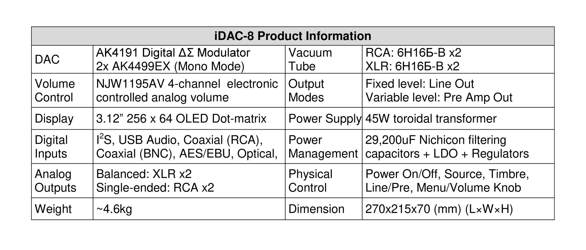

Features and Design Considerations of iDAC-8 DAC/Preamplifier
  1. Features a 3.3-inch 256*64 pix white OLED dot matrix display for a clear and intuitive display
  2. Offers 5 different digital output interfaces:
    • I²S (HDMI Type A)
    • AES/EBU (XLR3)
  3. Equipped with RCA single-ended and XLR3 balanced analog audio outputs. Both output terminals support line (LINE)/preamp (PRE) output modes, and the output mode can be selected directly through buttons.
    Line and preamp output modes can be used with integrated amplifiers and pure power amplifiers. The output level of the line output is not adjustable, and the system volume needs to be adjusted by the rear-end amplifier. The output volume of the preamp output is adjustable, and it can be directly connected to a pure power amplifier.
  4. The digital-to-analog conversion (DAC) uses the latest flagship AKM AK4191+AK4499EX chipset. Two AK4499EX chips are used, operating in MONO mode, with each chip responsible for one channel, and with a fully balanced architecture.
  5. The volume control in the preamp mode uses a high-performance Hi-Fi-grade four-channel volume IC NJW1195AV, which accurately and synchronously controls the volume of the two channels through four channels, achieving good channel consistency.
  6. Dual Timber circuit for both RCA Single-ended and XLR Balanced analog output.
  7. The tube timber circuit is composed of Russian 6H16Б-B dual-triode miniature tubes.
  8. Large capacity and ultra-low noise power supply system. Utilizes a high-performance toroidal power transformer designed and manufactured in-house, with a rated power of up to 45W. The main filter capacitors use six 3300uF and two 4700uF Nichicon aluminum electrolytic capacitors.
  9. L-shaped aluminum cover plate, precision extrusion molding, CNC precision machining, fine sandblasting, and anodized surface treatment.
  10. The left and right side panels feature large-area grooved heat sinks to improve heat dissipation efficiency.
