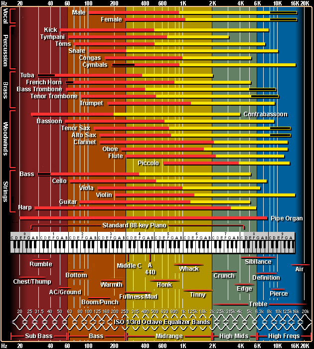

These are the fundamentals. The harmonics extend a little ways higher. Past 14kHz or so, there isn't much left.
Jan 24, 2013 at 1:20 AM Post #5 of 34
That chart starts to go south at the bottom.

My understanding is that the bottom of the chart assigns audio terms to frequency ranges, are those assignments wrong?
I think someone made them up figuring they needed to evenly space them out. Human hearing has zones where the types of sounds we hear cluster, and zones where nothing much happens at all. It isn't neatly spaced out like that, especially at the top end.
They've also got the piano keyboard too big, and if they're going to indicate harmonics, they should have them fade, because generrally, the higher the harmonic, the lower the volume. (Except with cymbals and triangles)
Jan 24, 2013 at 2:04 PM Post #13 of 34
The piano represented in that chart is a bit misleading and difficult to understand when compared to the other instruments shown.  One might assume that the last octave of a standard 88-key piano would be peaking at over 16kHz.  While I can't hear 16kHz anymore, I can definitely hear the highest key played on a piano without any difficulties.  I know it is not the intent of the chart designer, but  it seems poorly implemented.
Jan 24, 2013 at 2:12 PM Post #14 of 34
It shows more than 88 keys, those that are on a standard 88-key piano (A0-C8, 27.5-4186 Hz) have a white color, while the others outside that range are grey.
