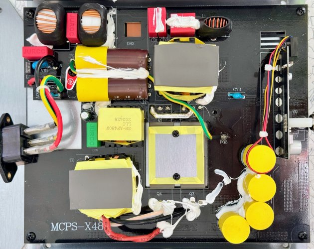

I will start this post with a strong DISCLAIMER:
  • Burson clearly told me that they do not recommend opening this power supply as there's a high risk of shock hazard and death, even several minutes after the device was powered off! Also, by doing this it will void the warranty!
  • Burson Fusion Core involves high voltage AC power and opening the case is highly risky and life threatening! I'm doing it here so curious head-fiers to not do it, so again: don't open your Fusion Core; if it's broken just contact manufacturer and follow their words, but don't open it!
  • Mounting the covers back is very difficult to be done and damaging the wires or some internal components could easily happen, due to the mechanical force that appears when pressing the top cover to fit back the screws into their halls. Also, the thermal pads might need replacing with new ones of the same quality, in respect with thermal conductivity value. So again: just don't open the case!
Double aluminum case for a better heat dissipation. Also, most components are perfectly glued on the PCB to resist vibrations.
Thermal pads on each transformer to prevent overheating and to prolong their operating life.
The four GaN Q1...Q4 transistors are located in the middle, but are soldered on the back of the PCB.
Yellow rubber covers on top of electrolytic capacitors to further eliminate any possible vibrations effects
The small fan from the rear-bottom is dead silent, but is evacuating the hot air from inside properly
