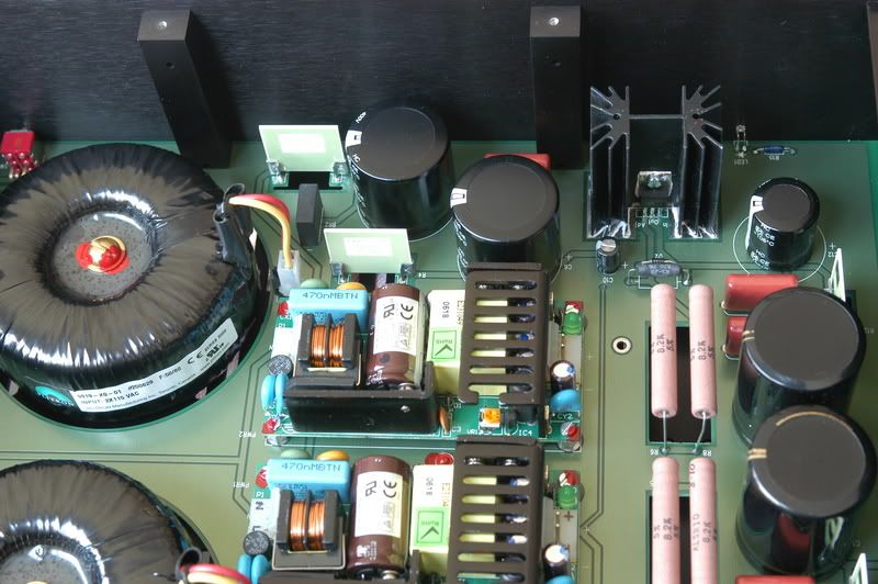

The power supply boards were redesigned to accommodate these heavy transformers by modifying a big opening in the PC boards and letting the 2 toroidal transformers rest on the bottom plate properly, fastened with ¼” bolts. This method helps the power supply to stay in one piece when shipped all over the world.
The B-52 has dual mono power supplies. Each dedicated to one channel. It is highly rectified using high quality Panasonic power caps, and state-of-the-art 10 watt ceramic resistors. This process ensures that the proper voltage is passed to the high voltage regulators that hold the voltage steady consistently without peaking or dropping as the input AC voltage fluctuates.
Every component is hand selected and matched between the left power supply and the right power supply. Each resistor has its value written on it before being matched with an identical one. The two power supplies have a tolerance within 1-2 VDC.
The two low voltage power supplies are UNIVERSAL “switching” regulated power supplies, rated much higher than necessary, creating 10 amps of current, between the two units, to feed the heater “filament” of the tubes.
The power supply is capable of running 3 amp sections of the B-52 without a problem.

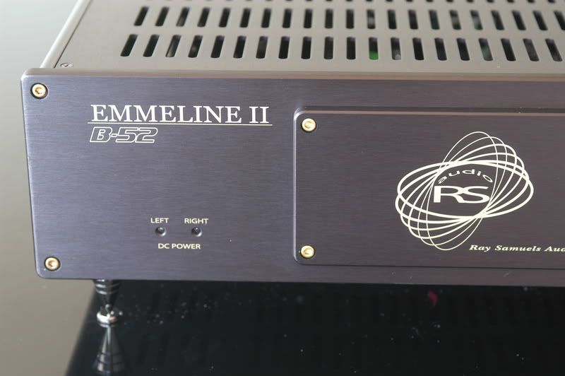

There are two LED’s on the face plate of the power supply each indicating that the power supply is outputting the correct voltage required. The chassis of the power supply is designed in a way to secure the PC board in four locations to make sure it will stay firmly locked in place. Also there is a center stand off that secures the pc board well to the bottom chassis. The other two sides of the pc board slide in a long groove channeled in each side of the extrusion, thus ensuring that the power supply is well secured to it’s chassis, which enables the unit to travel long distances and get to it’s destination without damage or loose parts..

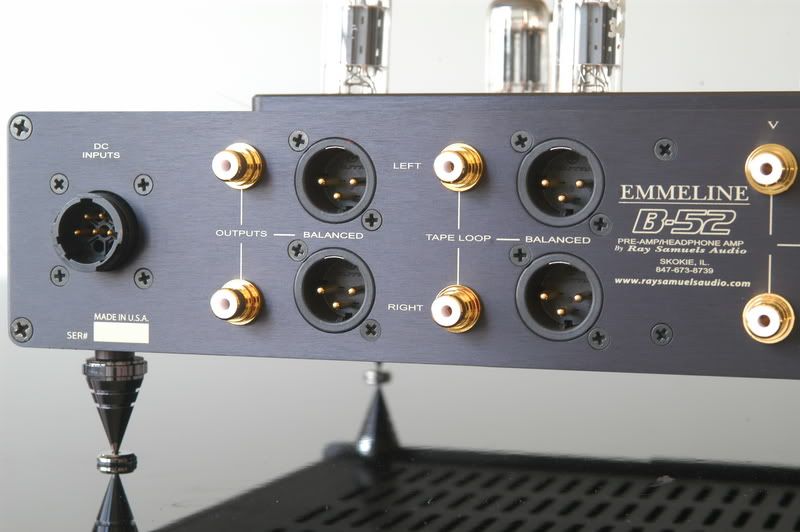

The B-52 has a tape loop/record out feature, both in the balanced and single ended mode.
If the balanced XLR input option has been chosen, the chosen signal path will appear as fully balanced on the balanced XLR tape loop and also will appear as a single ended on the single ended tape loop in RCA. This gives you two tape loops in both balanced & single ended mode.
If single ended, RCA, input has been selected, the “tape loop out” will have identical signal present at the RCA tape loop and the same signal will appear on the balanced XLR tape loop but in a single mode, as only pin #2 will be active, pins #1 and #3 will be shorted to the ground. This could be still used to copy a signal or activate another external amp even though it is using XLR connectors.
The same applies on the Headphone Amp Outputs. Both are active, balanced XLR & the ¼” headphone output when any input has been selected whether balanced or single ended.
For example, if you select balanced XLR input, the balanced headphone XLR is fully active as balanced output to drive any balanced headphones with XLR connectors.
At the same time the ¼” connector is active as a regular non-balanced output. This will give you the option to use your balanced cable between your source and the pre-amp yet the simplicity of plugging your 1/4” into your B-52 without disconnecting anything else, thus making B-52 a very versatile amp/pre-amp.
The same applies if you happened to own a single ended source & the selected input is a single ended, you can still hear your music even though your headphones with balanced cable/XLR are plugged in the B-52 balanced XLR headphone output. This is permitted as the amp/pre-amp will allow the positive signal to get to pin #2 & it shorts pin #3 to ground allowing you to listen to your non balanced source with ease without flipping switches or changing cables or grounding pins. All this is done internally with just one click of the selector input dial.
