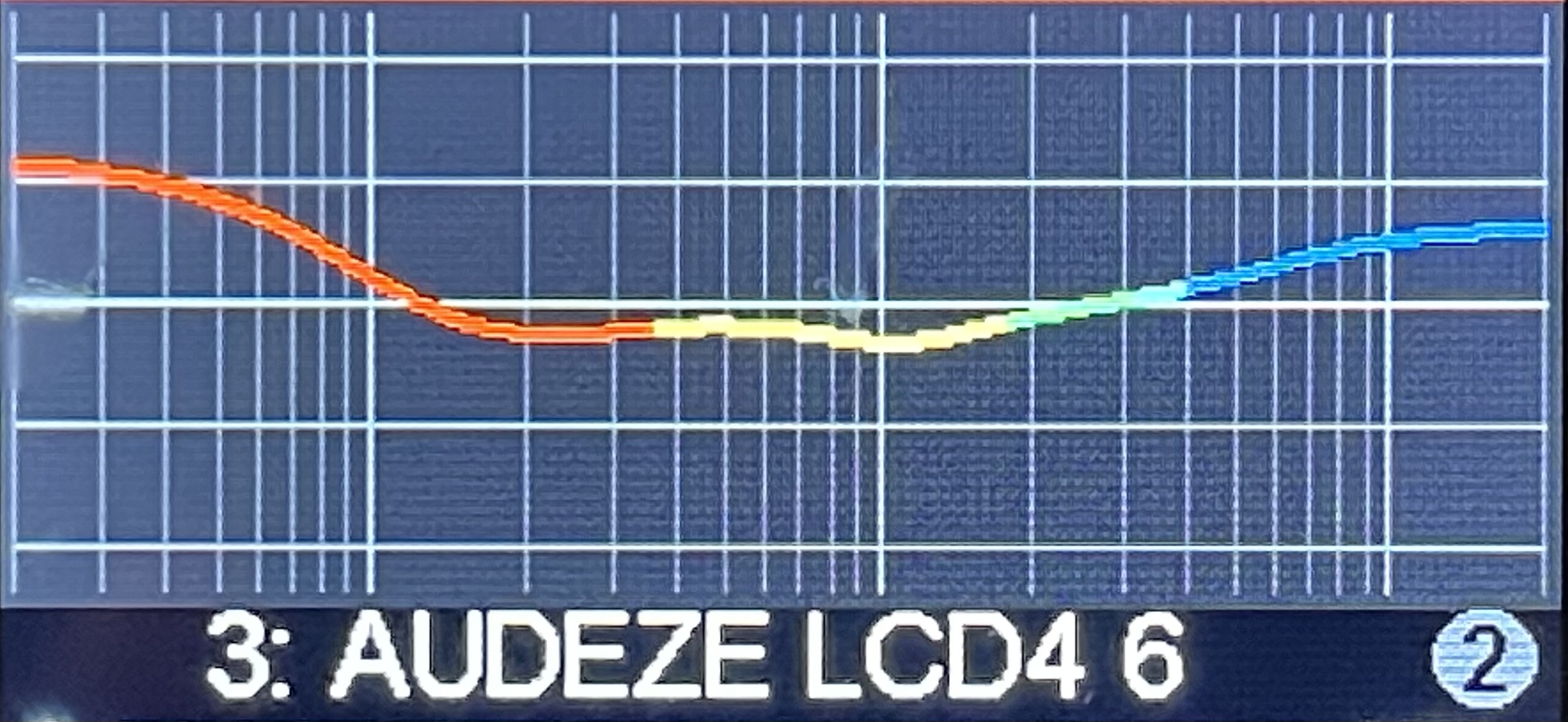

For the LCD-4 I’m happy with an EQ that I derived from Oratory, but cut the treble corrections to ca. 1/2, and did fine-tuning by ear.
Here are 2 versions of EQ that work nicely with various types of music:
Half-way adapted from ORATORY1990 / Harman:
Code:
B1: Gain +3.0 dB  F:   111 Hz  Q 0.6 Shelf
B2: Gain -1.0 dB  F:   130 Hz  Q 0.5 Peak
B3: Gain -1.5 dB  F 1.09kHz  Q 0.9 Peak
B4: Gain -1.5 dB  F 3.0 kHz  Q 2.9 Peak
B5: Gain +4.5 dB  F 3.7 kHz  Q 0.6 Peak
B6: Gain -1.0 dB  F 7.8 kHz  Q 2.3 Peak
B7: Gain +1.0 dB  F 7.2 kHz  Q 1.5 Shelf
Smoothed EQ for LCD-4, leaving AUDEZE‘s “house sound” intact:
Code:
B1: Gain +6.0 dB  F:   111 Hz  Q 0.6 Shelf
B2: Gain -2.5 dB  F:   130 Hz  Q 0.5 Peak
B4: Gain +3.0 dB  F 5.7 kHz  Q 0.6 Shelf

I am digging your EQ! I may try the "house sound" one as well, but your main one is great, and very natural sounding.
What amazes me is how imaging totally changes as you flip between EQ profiles. It's so wild.
