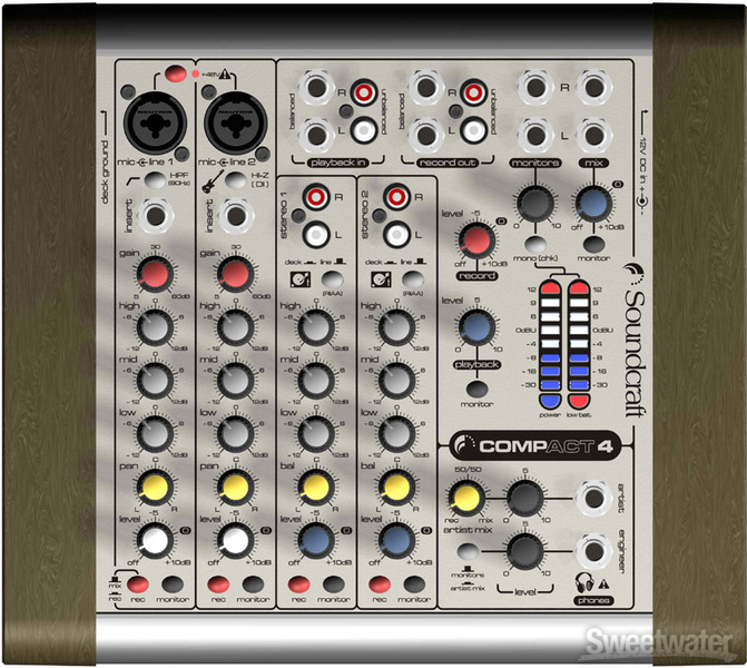

It sounds like you need a summing box. A mixer would work well for this purpose, since you could control the level of each input and route them all to the main output at once. You could set up the Aphex 204 as an insert (which is what most pro audio people would do), and adjust the send ratio between 100% and 0% to turn the effect on/off.

Thanks for the tips guys! I think I'll use an RCA box for now, and get a mixer once I've more money.
