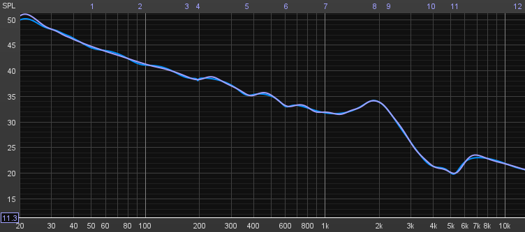

That response doesn't look particularly close to the convolution filter so it's no surprise they didn't sound the sameHuilo.
From here: https://forum.headphones.com/t/audeze-lcd-5-official-thread/14588/784
Granted, it does not look the same as it is just a copy or rough trace.
Accurate Sound convolution filters

?From the images above it does not look like that's being done here so for many people these convolutions will end up sounding very bad.
Mitch is not going above 5khz or 6khz tops, sometimes even lower.

That's correct. See my later comments regarding the adjustment?

Hi,@GoldenOne , I agree with everything you are saying, however, I think you may have overlooked the high frequency response limit of the chart that @Rayon posted. The chart goes up to 3 kHz...
Accurate Sound's convolution filters do not eq HRTF. There is no eq beyond 6 kHz, other than like you say, perhaps a high frequency shelf that adjusts the overall treble level to one's ears.
A FIR filter with 65536 taps @ 48 kHz has a frequency resolution of 48000/65536 = 0.732 Hz. The frequency range spans 0 Hz to 24 kHz (fs/2). Thinking of a FIR filter as a graphic equalizer: 24000/0.732 = 32768 sliders for our equalizer. That is 1000 times the frequency resolution of a 31 band 1/3 octave equalizer.
