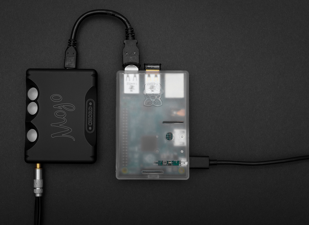

HARDWARE SETUP/ASSEMBLY:
Unpack everything, put the Pi in the case, plug in your Wi-Fi adapter and DAC and storage.  Once the SD card has been loaded with RuneAudio it can be inserted also.  That’s all, it’s pretty easy.
You need to run the internet connection off of the Ethernet port for initial setup to get your Wi-Fi setup and connected.  If you don’t have Ethernet near your audio setup you can share the connection of a laptop or another computer by bridging the connection and plugging the Ethernet cable into your computer.  Follow the instructions here (http://windows.microsoft.com/en-us/windows/create-network-bridge#1TC=windows-7)

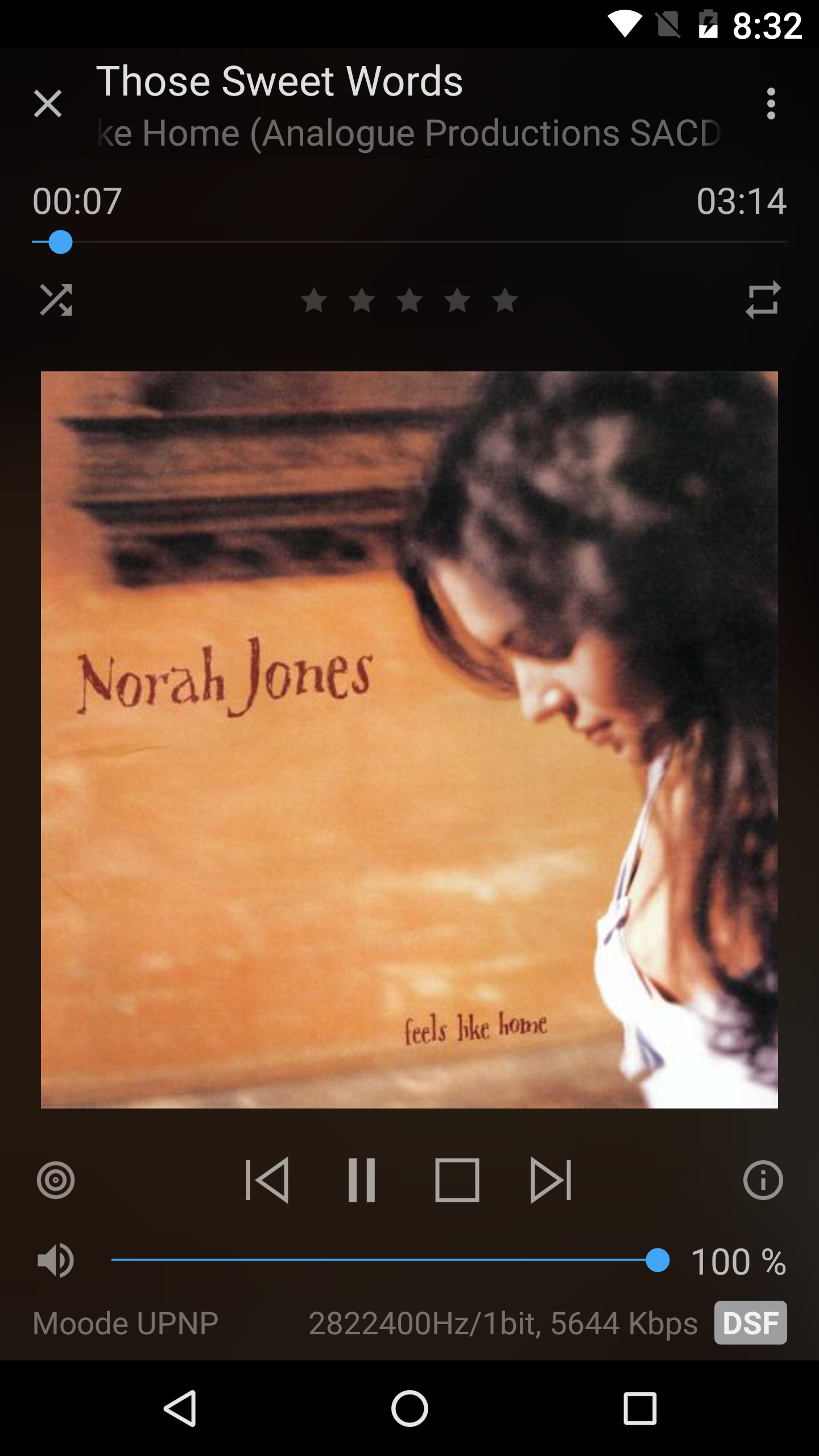

1.    Sit back and listen to music for a while!  You can use anything with a browser to access the WebUI.  I have used my iPhone, Laptop (Chrome) and my wife’s kindle with no issues.

READING FROM A NAS, DESKTOP OR OTHER NETWORK LOCATION
In the WebUI select "Sources" from the menu in the upper right hand corner.
Click "Add new mount" on the sources screen
Fill in the follwing as noted below:
Source Name = Anything you want it to be
Fileshare Protocol = SMB/CIFS
IP Address = The IP Address of your NAS or computer
Remote Directory = The name of your music folder.  Mine is stored at D:\My Music.  I would only enter "My Music"
Click Guest Access to turn it off.
Username = Your Windows logon
Password = Your Windows password
Click "Save Mount" and you should now be able to access that folder form your Pi via the library.
