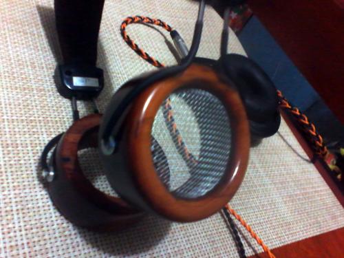

Actually, maybe cutting and gluing a metal mesh screen in lieu of the plastic grill would be worthwhile. Anybody wanna try it? Or will I have to be the first?
Jul 11, 2005 at 2:26 AM Post #17 of 542
I did that to my HD497s...replaced the drilled plastic grille with aluminum screen mesh. I'm surprised how great they sound now...they're actually listenable

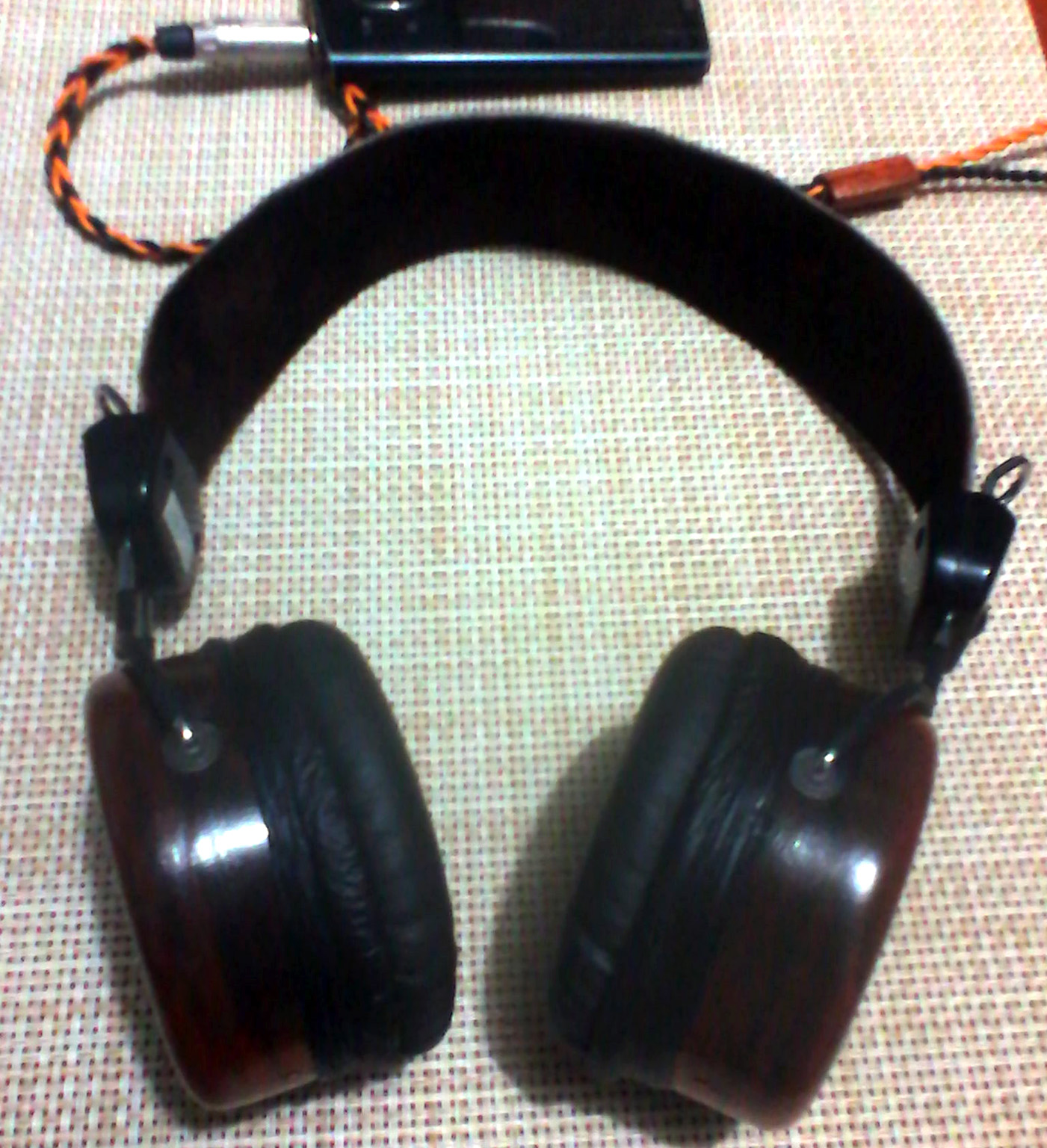

Actually, I am looking for an enclosure for the ksc-50 drivers.
I broke all plastics on them. After that, I mod them (re-cable). Now, I can listen to them but no housing for them. They sound beautiful, recabled with speaker wires. Does anyone have an idea what can I do with them, aside from selling them?
I broke them. After that, I mod them (re-cable). Now I can listen to them but no housing for them. Does anyone have an idea what I can do with them, aside of selling the drivers?
Do another Kramer-mod and mount the Koss drivers in some other headphones housing!
Jul 11, 2005 at 2:54 AM Post #20 of 542
I've been looking, but not luck. Last time, I tried some American Airlines headphones, but the drivers didn’t fit very well. I managed to install it but, since they were closed, they didn’t sound right.
By the way, with the re-cabling, sound open up a lot. Especially, bass spectrum.
Jul 11, 2005 at 8:55 AM Post #21 of 542
Make ATH-EW9s clones with them- give the drivers a wooden enlclosure with leather earpads and metal based clipon pieces. Classy. Now if only I could get an EW9s smiley...
