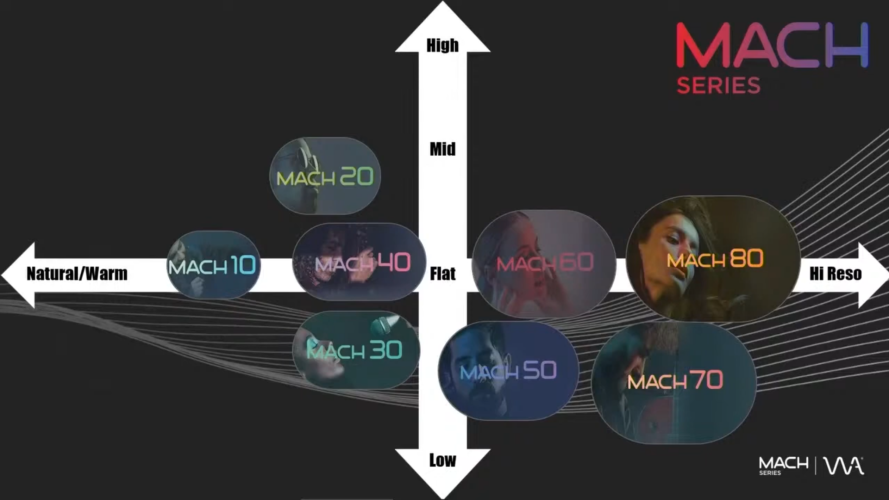

8 IEM from 10-80, sounds like a lot and confusing, but its simpler than most people think. The MACH Series is divided into 3 lineups.
So the MACH 20 is the ""flagship"" of the Entry Lineup. The 70 is the flagship of the Bass Lineup and the 80 is the flagship of the Reference Lineup
The difference between the Bass Lineup and the Reference Lineup is the bass BA. Quite a few people (including reviewers) get confused on why the Bass Lineup has one bass BA while the Reference lineup has two bass BA.
Size does matter in the end. Here you have an comparison of the bass BA in the MACH 70 compared to the two bass BA in the MACH 80
The Bass Lineup has only one, but an significantly larger one, while the Reference Lineup has two smaller ones, resulting in an faster and more accurate bass representation.
So even though looking confusing at a first glance, it is simpler than one might think. Its a decision of budget and what target want. You want fat bass? Check the 30/50/70 and choose the right one based on your budget. You want a reference sound, its 40/60/80 and your budget.
