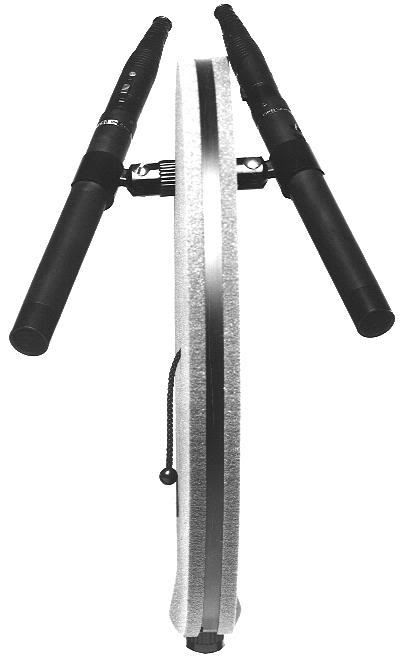

There are other ways to achieve binaural recordings. The second most popular method is using what is called a Jecklin Disc or Jecklin Baffle.
The idea of using an absorptive baffle between two omni directional mics was first proposed by Alan Blumlein, but was later refined and perfected by Juerg Jecklin (I think it is the same guy who makes those ugly electrostatic headphones).
Anyway, Jecklin's baffle was 300mm in diameter, made of 3/8" plywood covered with about 1" of foam and sheepskin on each side. However, the precise thickness of the baffle doesn't appear to be critical. I have tried baffles of about ½ an inch to 4 inches thick and it made little difference. The important thing to focus on with a Jecklin disc is the 165 mm (8 inch) distance between the two omni directional microphone capsules. This places each microphone to about….you guessed it, the distance of the human ears.
THE JECKLIN DISC
http://i26.photobucket.com/albums/c1...no/jecklin.jpg
http://i26.photobucket.com/albums/c1...leno/jdisk.jpg
