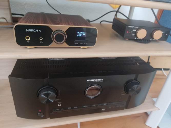

Hi guys,
I have the special edition of this device now for one week and i thought i share some impressions. I bought the special edition because of the cool looks even i couldn't find anything if there was something changed beside the look. After one hour of listening it seemed pretty bright to me and i couldn keep listening anymore without my ears starting to hurt. I listened about 30mins with a Sennheiser HD650 and about 30mins through the balanced xlr out into Aiyimia Monos with Dynaudio Speakers. Both had the same bright sound.
I then let the device play some music without listening in hope of getting some improvement with warming the device up but it didnt change anything. I still listened everyday for atleast an hour in hope of some improvements or me getting used to the sound but it always sounded too bright for my taste.
The online pictures of the inside of the device showed some easy to swap OP amps therefore today i thought i give it a try because it could get worse anyway. After opening the device i was pretty perplexed to see that the special edition had 2 Muse02 Op Amps and 1 NE5532 Op Amp installed. I have the Muse02 Op Amps allready installed in my Aiyima Monos and there they wont sound bright at all. The NE5532 Op Amp also had total different looking print on the top side than the standard NE5532 Op Amps from Aiyima Monos. I swapped the 2 Muse Op Amps in the March V for the old NE5532 from my Aiyimas and the one NE5532 from the March V i swapped with an oraclell-02 lying around here.
Now im listening since more than 1 hour without any ears hurting. The brightness is gone and i like it listening throught the XLR and the 4,4mm output and I'm looking forward getting even some better OP Amps to improve audio quality even more.
greetings orangensaft
