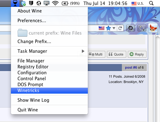

3. When Wine.app is is updated, a MenuBar icon should be installed in the upper right corner of your screen (icon surrounded by red in the screenshot below)
4. Click on the Wine.app MenuBar icon and click on Winetricks
5. Wait for it to do its thing

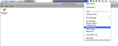

7. Click on the Wine.app MenuBar icon again and click on Control Panel
8. Double-click on Add/Remove Programs and press Install
